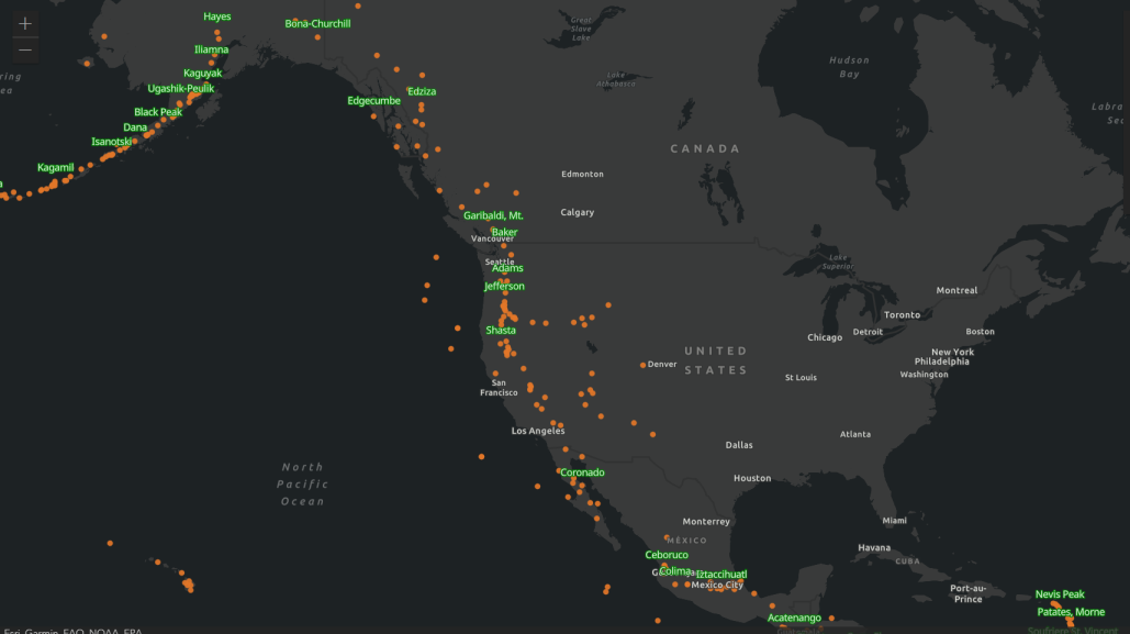

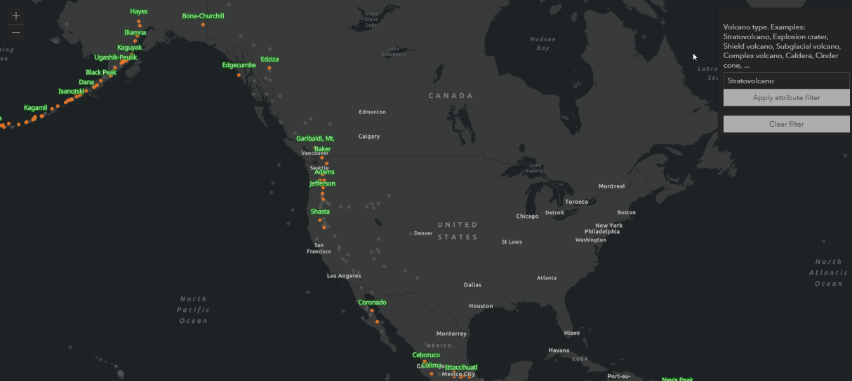

I have a web app that apply Feature Effect and Labeling on a Feature Layer.
Firts I apply a Feature Effect:
layerView.featureEffect = null;
let featureFilter = new FeatureFilter({
where: "Type = '" + document.getElementById("filterText").value + "'"
layerView.featureEffect = new FeatureEffect({
filter: featureFilter,
excludedEffect: "grayscale(100%) opacity(30%)",
excludedLabelsVisible: false
Then I clear the Feature Effect:
I can only see labels on features filtered by the previous Feature Effect.
Can I see labels on all features after clear a previous FeatureEffect?

Hi!
It was my fault. The problem was in the "excludedLabelsVisible" property, it has to be true for enable labels of excluded entities.
this.pointsLayer.featureEffect = new FeatureEffect({
  filter: new FeatureFilter({
    objectIds: [
      hit.graphic.attributes[
        constants.arcgis.layers.backhauls.fields.objectid
  excludedEffect: 'opacity(90%)',
  includedEffect: 'bloom(0.6 0.1pt 0) contrast(130%)',
  excludedLabelsVisible: true
@LuisAntonioRodriguezGonzalez In your example, the value is set to false.
