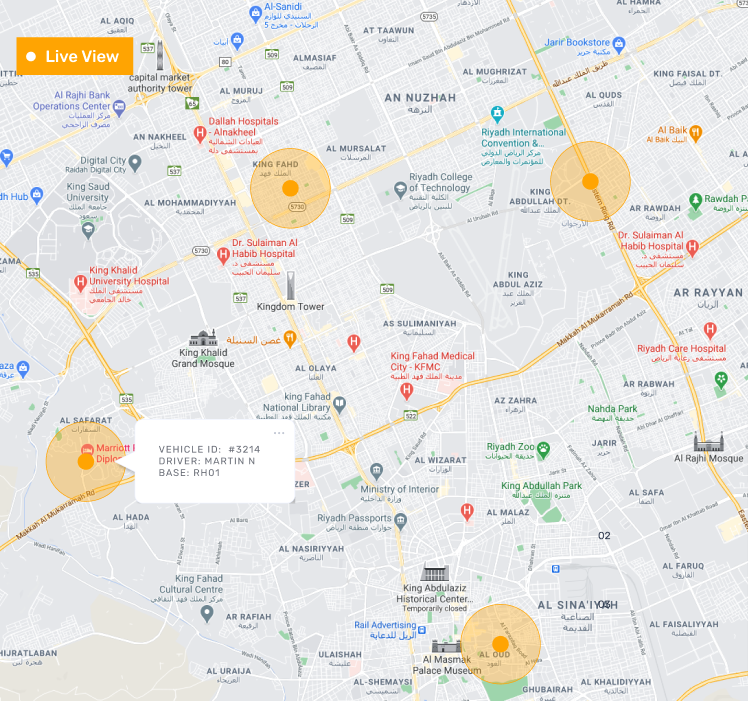

Here below is my next JS Code which is showing simple map.
Can anyone please let me know that how can I display pop up or Info window on the marker location?

In above code, API call is doing by  getServerSideProps and data as array of objects is passing to the component using props.
I need to display information as below.
