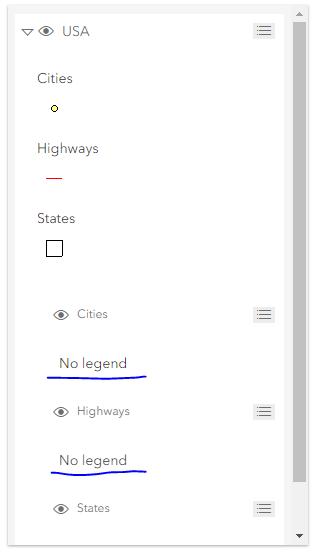

I am trying to modify one of the samples that combines the Legend and LayerList widgets to also accommodate sublayers. It seems that if leave the default layerlist declaration (as the sample provides), it gives me all of the symbology for the sublayers at the top, and nothing inside of each sublayer.
Originally, I had thought that I would just assign the "legend" to the panel of the children the parent layer, but that didn't seem to work. Any thoughts or references where this has been done before?

I'm not really sure if this was a good solution, but I was able to put something together. Does anybody have any suggestions? In addition, it seems like this 'listItemCreatedFunction' is happening a bunch of times (executing more times than the number of layers'. It doesn't seem to interfere with anything, but I'm wondering if it will slow down the map when expanding to multiple services with many sublayers.
See codepen for live example: Add a Legend to a Layerlist (Sublayers Edition)

          if(layerNumber != -1){
       for (let j = 0; j < response.data.layers[layerNumber].legend.length; j++) {
       var para = document.createElement("P");
       para.style.margin = "2px";
       para.style.verticalAlign = "middle";
       var img = document.createElement("img");
       img.style.height = "20px";
       img.style.verticalAlign = "bottom";
       img.src = item.layer.url + "/images/" + response.data.layers[layerNumber].legend.url;
       theLabel = response.data.layers[layerNumber].legend.label;
       var t =  document.createTextNode(theLabel);
       para.appendChild(img);
       para.appendChild(t);
       aDiv.appendChild(para);
         item.panel = {
      className: "esri-icon-drag-horizontal",
        content: aDiv,
                                              open: false,
        visible: true
          } // if(layerNumber != -1){

matt price‌ awesome, great work! I did have to do one update.. toggling Group on/off did not work (for me).  With a dynamic map service with some Groups and subGroups loaded as a mapImageLayer.
I first noticed interestingly that Group layer items (parents with children or subchildren sublayers) were not showing up with checkboxes, at all. Just the triangle expand/minimize arrows. So there was no way to turn on layers in a group if the parent Group was off.
So...I removed this chunk of CSS, below. Ok, so the Group checkboxes came back and appear as normally. But clicking the parent/group checkboxes doesn't do anything.
https://codepen.io/kevinsagis/pen/RwajJRa
.esri-layer-list__child-toggle + .esri-layer-list__item-label:not([role="radio"]) > .esri-layer-list__item-toggle {
display:none;
However, the fix was that I deleted this part of a line:
item.children.items.length === 0 &&
So instead of  if (item.children.items.length === 0 && item.title != "Legend") {
it's now just  if (item.title != "Legend") {
Now it works. Hope this helped everyone.

Hi All,
I did not find any solution for this anywhere and few solutions were leading to too many network calls, so developed a workaround. Sharing the code below might help others:
1. Querying the legend images url and store in an object
let that = this;
    query: {
        f: 'json'
    responseType: "json"
  }).then(function (response) {
    response.data?.layers?.forEach((element: any) => {
      let layerId: string = element.layerId;
      if(element.legend.length>1){
        let legendArr: any = [];
        element.legend.forEach((item: any) => {
          legendArr.push({url: item.url, label: item.label})
        that.legendImage[layerId] = legendArr;
      else{
        that.legendImage[layerId] = element.legend[0].url
2. Adding Image to Legend sublayer panel
const layerList = new LayerList({
    view: view,
    listItemCreatedFunction: (event) => {
      const items = event.item.children._items;
      if(items){
        for(let i=0; i<items.length; i++){
          let img = document.createElement("img");
          if(that.legendImage.hasOwnProperty(items[i].layer.id)){
            if(typeof(that.legendImage[items[i].layer.id])=='object'){
              let div = document.createElement("div");
              let count = 0;
              that.legendImage[items[i].layer.id].forEach((el: any) => {
                div.innerHTML += "<img src='" + el.url + "'>  " + el.label;
                if(count<that.legendImage[items[i].layer.id].length -1)
                  div.innerHTML += "</br></br>";
                items[i].panel = {
                  content: div,
                  open: true
                count++;
            else{
              img.src = that.legendImage[items[i].layer.id];
              items[i].panel = {
                content: img,
                open: true
