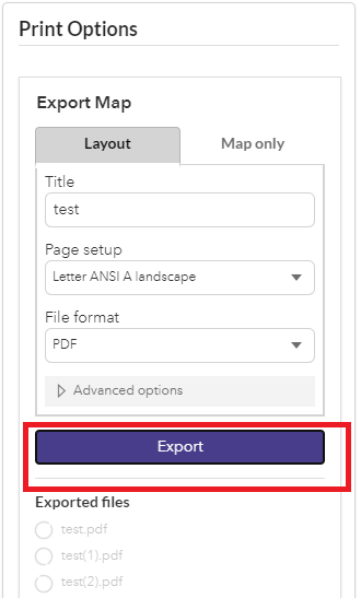

I'd like to disable the print export button when the user is in the process of exporting their map.
Export button from Print widget
Currently, a user is able to repeatedly generate map exports while an export is taking place. Is there a way to disable the button until the export has completed?
