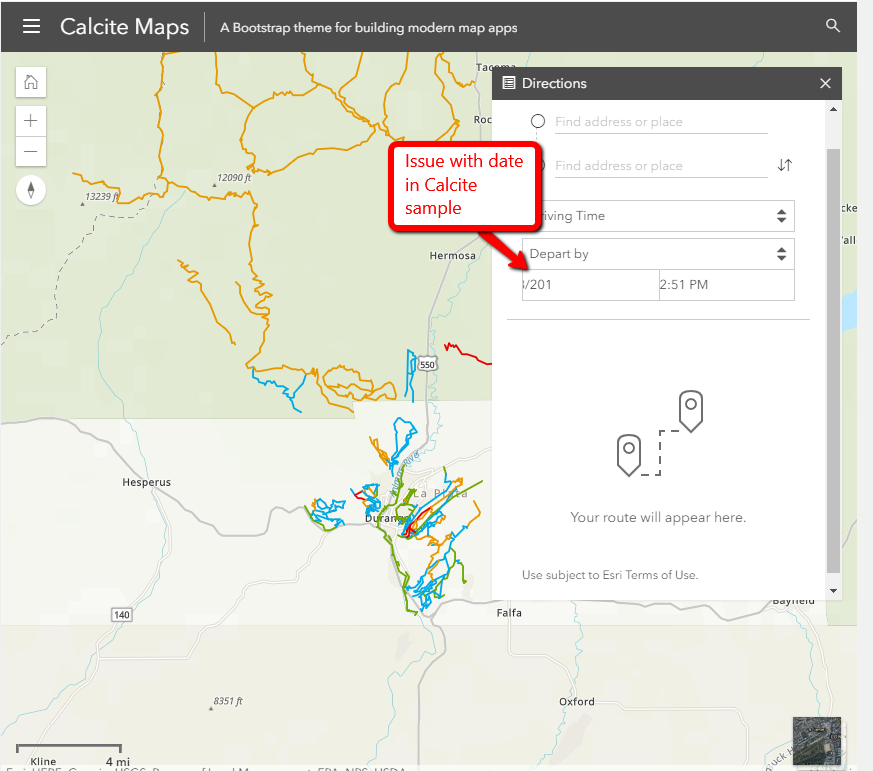

Hi,
When I am trying to integrate the Directions widget in Calcite sample app of AGS api JS 4.9, Depart by Date display "/201" in Calcite App. Directions widget works well in Esri samples. Please help me.
Here is the code.

Add these css rules to fix that:
    .esri-directions__departure-time-controls .esri-time-picker {
      padding: 0 0.5em;
    .esri-date-picker__calendar-toggle {
      width: 100% !important;
RobertScheitlin__GISP
MVP Emeritus
      padding: 0 0.5em;
ImtiyazPasha
Thanks a lot, Robert.
