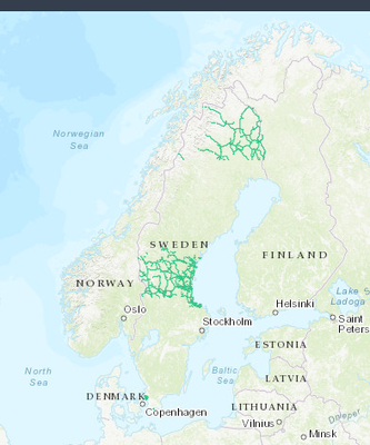

Good Day
We have a large view of the entire country of Sweden, and when we're zoomed out the Feature Layer isn't rendering completely.  If we zoom into smaller areas the view is correct, but at a zoomed out view it's very broken.  We've noticed the same issue in ArcGIS Online, is this a bug?
We'd like the entire country filled in, as we have data for it, not sure what's causing this.

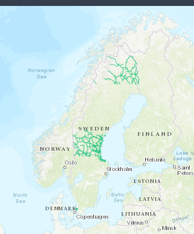

It's a bug, I dropped to 4.16 and the output it right,

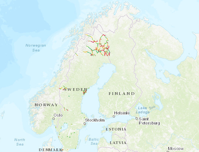

Sorry about the late reply, I tested on next and this is what rendered:

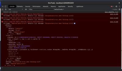

Which is the same kind of behaviour I'm seeing with 4.17.  I'm not allowed to release the host feature layer, not my decision, sorry.   I disabled and enabled all the features and the view didn't change, I left it for a solid 5 minutes to render which about 4.5 minutes longer then it ever takes.  I noticed some errors in the console:
