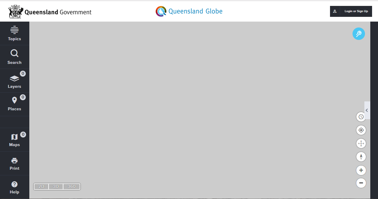

A client of us have reported that from their corporate network, they are not able to access our public map application.
https://qldglobe.information.qld.gov.au/ which is built using ArcGIS API for JS 4.10
When they click Get Started, they see all the contents except the map.
Grey window instead of ArcGIS JS Map
Client has checked on multiple Computers and different Browsers and the result is the same.
Client has checked all Firewall Rules, and nothing is blocking on their side. They do not have a proxy.
Any idea what is happening?

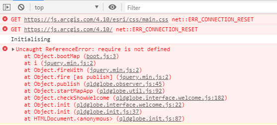

   I am not seeing JS API being blocked when I access that site. Here is the errors I see. Notice Render.js is from the JS API so the API is not being blocked.

Yes, Robert, but you're not behind their client's firewall .
I think at first you need to be sure if it's network or machine related.
Perhaps you could ask your client if they have the same issue when connecting tothe site via one of their home-networks, but still on the same machine ?
