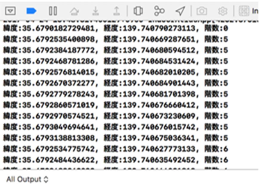

func indoorLocationManager(_ manager: IALocationManager, didUpdateLocations locations: [Any]) {
  // 緯度・経度・階数情報を取得
  let iaLocation = locations.last as! IALocation
  let clLocation = iaLocation.location
  print("緯度:\(clLocation!.coordinate.latitude), 経度:\(clLocation!.coordinate.longitude), 階数:\(iaLocation.floor!.level)")
