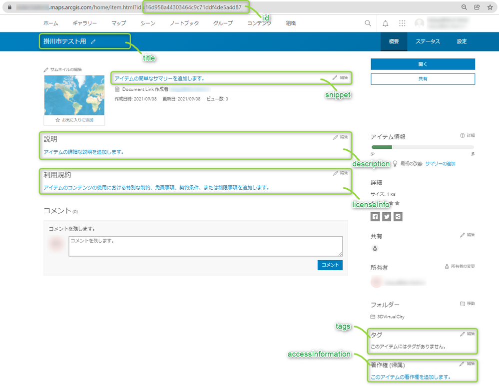

In this sample we will update title, snippet, description, tags, licenseInfo, accessInformation. To help you understand more intuitively, here is a correspondence between keys specified in item_properties and actual screen elements.
- id : Item ID
- title : Title
- snippet : Summary
- description : Description (HTML allowed)
- tags : Tags (If multiple tags exist, separate with commas)
- licenseInfo : Usage Restrictions
- accessInformation : Copyright Information

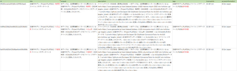

1.2 Organizing Item Details Information into Excel
Since we understood what information organizes item details to be updated, enter each key of item_properties in row 1 of Sheet1 (in the sample Excel file named “UpdateSheet1” for example), then enter each item's properties from row 2 downwards (using keys converted by .to_dict() within code). Note that column names in row 1 must exactly match keys of item_properties.
Also note that since description column contains HTML but should be unified into easier-to-read descriptions visually, VBA macro was actually used for updating. Because distributing Excel files with macros may cause security issues around here’s macro code provided separately as “UpdateDescription_SampleVBA.txt” for your reference if needed.
Figure - Example of organizing data in Excel (Example input from sample Excel file used in development test environment)

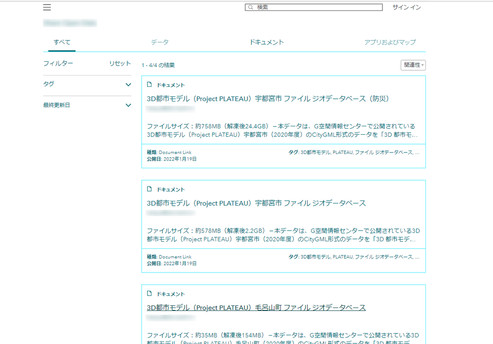

Also, in the ArcGIS Hub catalog site, it appears as follows.
Map - Example after updating a standalone item (ArcGIS Hub catalog site item details: Development test environment catalog site)
Here, if you focus on the center of the catalog site screen on "3D City Model Utsunomiya City (Project PLATEAU) File Geodatabase" and look at the description of the ArcGIS Online item details above (the description column in Excel), 107 characters are displayed. In other words, when publishing data on ArcGIS Hub, prioritizing necessary information in the first part of the description text of the item details is one technique to save double entry effort when making data public.
