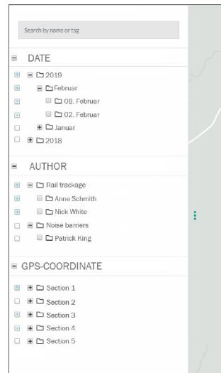

2.) When field crew done with field surveying, the images should be sorted in a very structured way in another serviced web application. Main folders should be Date, Author and Location. Sub-folders should be automatically separated by month & day of image capture, by name of the field surveyor, by predefined locations (probably separated by a geo fence). Here a little mock-up, how this should look like:

2.) You can reorganize the photos after all your data is collected, but the photos are already collected with the observation points from the field. These points contain one or many photos. These points all have the prerequisite metadata you require based on how you setup your collection (e.g., location, date, time, related area, etc. ). These points are stored as Feature Services and therefore are organized in the manner you need them to be. You may want to use our Attachment Viewer template to create is a simple app that allows users to see the photos in context via a map like this one for example. If you still want these images organized outside of a database service-driven feature, you could create automation to read the feature service and move the photos to a file-based server with the organization you desire based on the point data.Once your pictures have been captured and downloaded, there are plenty of scripts out there for watching folders and renaming things but nothing we have in our platform.
