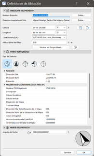

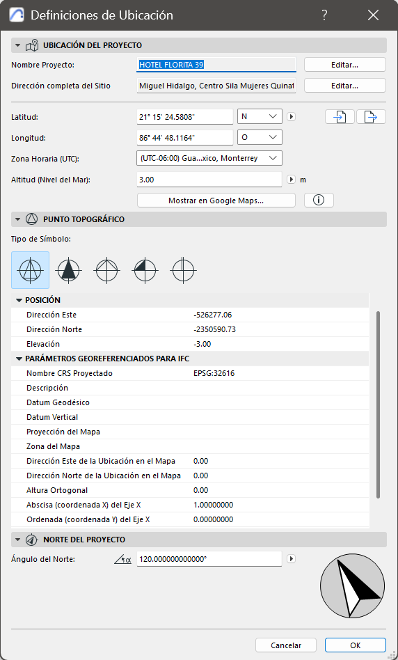

I need help to know how my architect coworker have to correctly configure the georreference for a BIM model in Archicad to export them later in a IFC File that I can consume in ArcGIS Pro for an urban project.
Here is the thing, he is writing coordinates like this:
He is inserting the corrects coordinates but when I import the BIM Model, is in the origen (0, 0).

I don't have Archicad to test the export, but my suggestion based on the screen capture you shared is to export the files as it is. The only issue i see is the negative value on the POSICION as i will expect a positive values (UTM)
"Expected" values
526289.35E m
2350589.10N m
