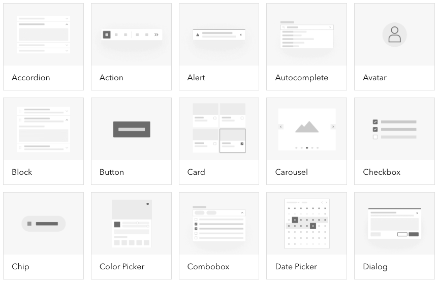

Grid of components in Calcite Design SystemGrid of components in Calcite Design System

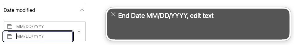

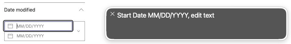

The Input Text fields have accessible names: aria-labels for "Start Date" and "End Date". These are defined inside the Shadow DOM and cannot be modified by applications that use the component.
However, regardless of the application where this component may be used, a screen reader user will always hear those labels.
Figure: Voice Over, a Mac OS screen reader, is focused on the first text field in a date modified search results filter. The gray dialog visually displays what is being heard. This includes the label Start Date, the placeholder text MM/DD/YYYY and the type of input field, which is editable text.Figure: Voice Over, a Mac OS screen reader, is focused on the first text field in a date modified search results filter. The gray dialog visually displays what is being heard. This includes the label Start Date, the placeholder text MM/DD/YYYY and the type of input field, which is editable text.
Figure: Voice Over, a Mac OS screen reader, is focused on the second text field in a date modified search results filter. The gray dialog visually displays what is being heard. This includes the label End Date, the placeholder text MM/DD/YYYY, and the type of input field, which is editable text.Figure: Voice Over, a Mac OS screen reader, is focused on the second text field in a date modified search results filter. The gray dialog visually displays what is being heard. This includes the label End Date, the placeholder text MM/DD/YYYY, and the type of input field, which is editable text.

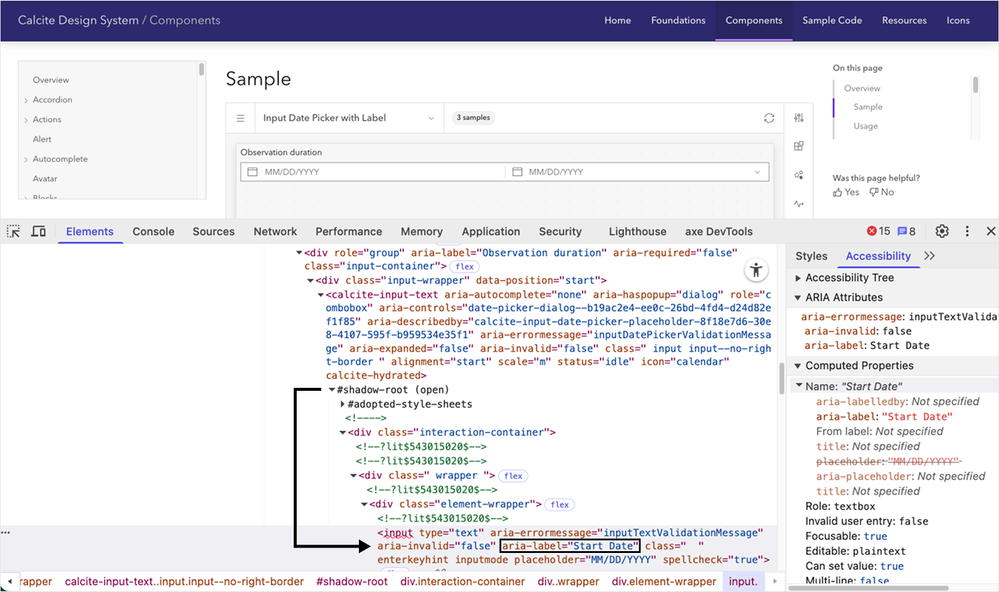

Figure: Calcite Date Picker with developer tools expanded to highlight the HTML text input, which contains an aria-label of Start Date. The HTML text input is within the Shadow DOM (or shadow-root) of the <calcite-input-text> component, which is a customized version of a Web Component.Figure: Calcite Date Picker with developer tools expanded to highlight the HTML text input, which contains an aria-label of Start Date. The HTML text input is within the Shadow DOM (or shadow-root) of the <calcite-input-text> component, which is a customized version of a Web Component.

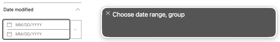

The Calcite Date Picker component also provides a label property. This property allows applications to configure content inside Calcite’s Shadow DOM and it is rendered as an aria-label on a group that wraps the Date Range Picker to offer more context to the end-user.
Figure: Voice Over, a Mac OS screen reader, is focused on a group role wrapped around both the Start and End date fields. The gray dialog visually displays what is being heard. The group has a non-visible aria-label of Choose date range.Figure: Voice Over, a Mac OS screen reader, is focused on a group role wrapped around both the Start and End date fields. The gray dialog visually displays what is being heard. The group has a non-visible aria-label of Choose date range.
Figure: Calcite Date Picker with developer tools expanded. The code highlights the group role wrapped around the Calcite Input Text component <calcite-input-text>, which provides applications with a customizable aria-label within the Shadow DOM of Calcite’s parent Web Component <calcite-input-date-picker>. Because the Date Picker is made of multiple elements, there are two levels of Shadow DOM involved.Figure: Calcite Date Picker with developer tools expanded. The code highlights the group role wrapped around the Calcite Input Text component <calcite-input-text>, which provides applications with a customizable aria-label within the Shadow DOM of Calcite’s parent Web Component <calcite-input-date-picker>. Because the Date Picker is made of multiple elements, there are two levels of Shadow DOM involved.
Despite the presence of three labels—the group label, and the field labels for both text inputs—Axe reports Date Range Picker as missing a label. This is because the root component <calcite-input-date-picker> that displays in the Light DOM doesn’t appear to have a label. In reality, it has three labels, they are just lower down in the Shadow DOM. If testing this component with a screen reader, one will hear all three labels, meaning this error does not affect the user-experience.
