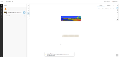

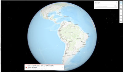

WHAT IS the appropriate spatial reference to publish voxel, my voxler layer has "WGS 1984 Web Mercator (auxiliary sphere)
" or is it actually another problem why the basemap is not seen in my scene?
Andrew--Johnson
Hi,
The issue is the Scene Viewer requires cached layers to have the same horizontal as well as vertical coordinate system. Since there is a mismatch in the vertical coordinate system the basemap is automatically dropped.
To get around this you can create a projection file with Web Mercator horizontal coordinate system only. You can then place it next to the netCDF file in the file system. From there add the netCDF as a voxel layer and create a voxel scene layer and the basemaps should remain in the scene.
