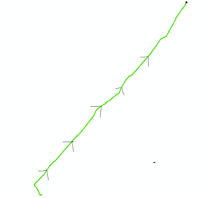

This is the route line in arcmap/server with arrows showing the line direction
Original Line -in argis
This is the route line kmz  as seen in Google Earth. I used To KML  to export the line to KMZ.i have marked arrows to show the direction the line takes when using Play Tour tool.
KML-Export using ToKML
I use version 10.4 (also this the same issue in 10.2.2)
I converted the KMZ to KML and saw that the vertex coordinates are in reverse direction in the kml. Upon searching in net i didnt get many people facing this issue but i found that a patch for 10.5 version is available which addresses this issue.
10.5 patch update
Didnt get anything for 10.4.
