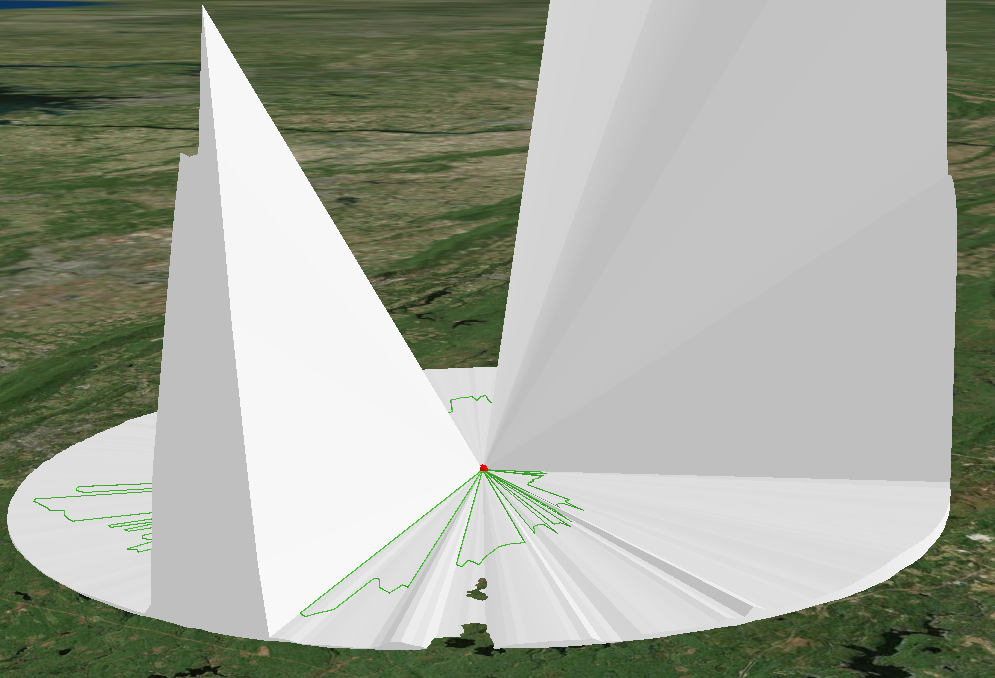

I need to create maps that depict where an aircraft can fly and have an unobstructed view of the receive antenna. I do not have much experience in 3D, so bear with me.  My idea was to use all returns of LiDAR in the area to create an elevation raster surface. Next, create a volume (multipatch?) up from the area of interest, then somehow cut out the areas that can't be seen by the receive antenna.  I would then create polygons at various elevations and clip them with the multipatch to create simple maps to deploy.
I found this article: ArcGIS Help (10.2, 10.2.1, and 10.2.2) and thought it could be a start. The problem is, I get to the limited directions in "Extended analysis, case 2" where things go wrong. I have created the Skyline from the 30' elevated 3D point and then run Skyline Barrier with every conceivable variation of settings, getting either no result that I can see or the complete opposite of what I expect to get (like the 1st picture in "case 2").  The result that I can see is a multi patch of what the 3D point should not be able to see, but also everything below the plane of the 3D point. (I will add a picture as soon as I can)
