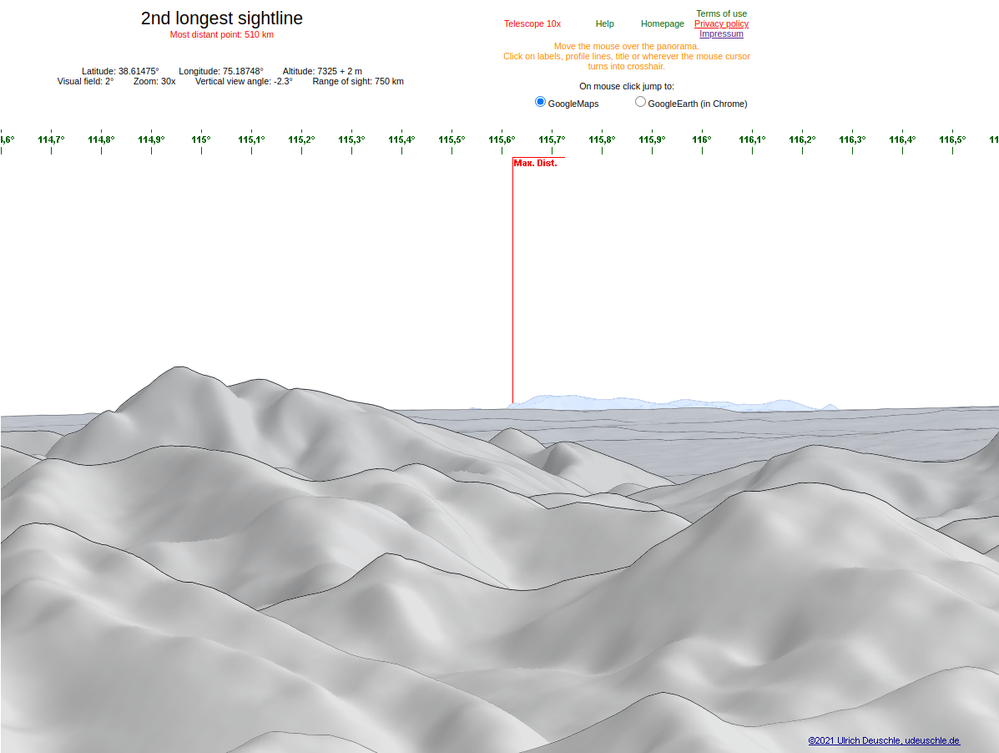

I'm happy to report that I finished a multi-threaded version of my program. I have been running it for about 1 hour and it already found a previously unknown(!) 510-km sightline:
Viewpoint location: 38.61475,75.18748 (China)
Bearing: 115.6°
Location of end point on horizon: 36.518409,80.331178
Length of sightline: 510.3 km
According to the list at https://web.archive.org/web/20190516221621/https://beyondhorizons.eu/lines-of-sight/ this makes my finding the 2nd longest sightline on the planet
I have decided to enlarge the scope of my search and to analyze 2.3 million viewpoints. This should take multiple weeks to run on a beefier PC.
I have confirmed the 510-km sightline using the udeuschle.de panorama generator (link: https://www.udeuschle.de/panoramas/panqueryfull.aspx?mode=newstandard&data=lon:75.18748$$$lat:38.614... )
