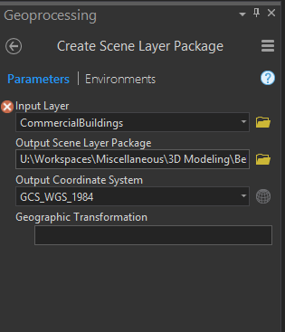

"Input Layer (Required)
ERROR 002102  Unsupported properties set in the layer.
 The 3D points, multipatch feature layers, or LAS data (LAS, ZLAS, or LAZ) that will be used to create a scene layer package. LAS data can also be specified by selecting the parent folder that contains the desired files."
The input layer contains multipatch features (created from las data) with CityEngine rule package for building details applied to it in ArcGIS Pro. The layer uploads to AGOL with a single solid color symbology, but cannot create a package with detailed symbology.
Is there another way to upload realistic buildings to AGOL?

Julie,
In the ArcGIS Solutions for Local Government page, there is an option for making realistic-looking buildings. Take a look here (it's the last option at the bottom):
Explore Local Government 3D Basemaps - Local Government 3D Basemaps | ArcGIS Solutions for Local Gov...
If this is a CityEngine‌ issue/task, then this thread might need to be moved to that space on GeoNet.
