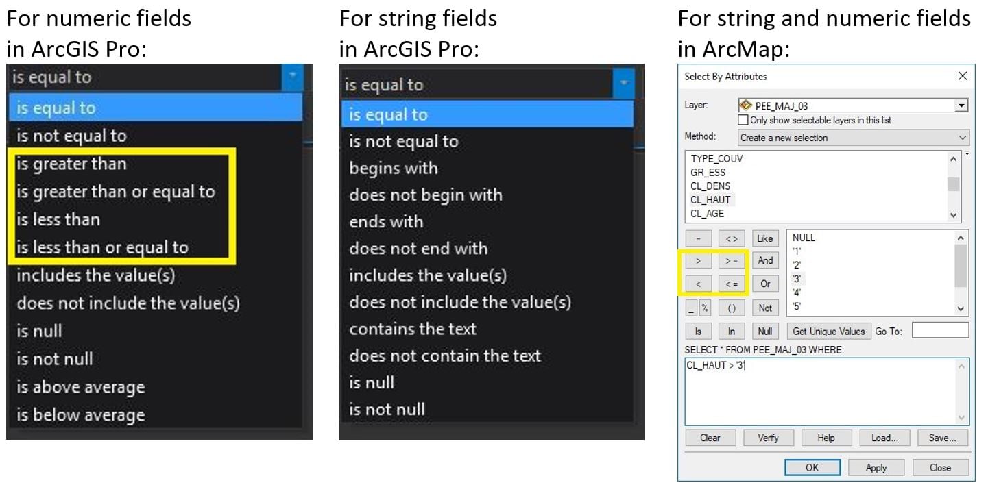

When we use Select by Attributes for example, in Clause mode of the Query Builder, the choice of expressions depends on the field type because ArcGIS Pro is context-sensitive. We often need to make selection on data which are string field. If we want to select values that are greater than «>», we need to select «is equal to» and after switch to the SQL mode and replace manually «=» with «>». In ArcMap, the option was available directly in the SQL query builder. We would like to have all the expressions for string fields in Clause mode of the Query Builder in ArcGIS Pro that were in ArcMap. Those query are now only possible if we are writing our own SQL query which is time consuming.
