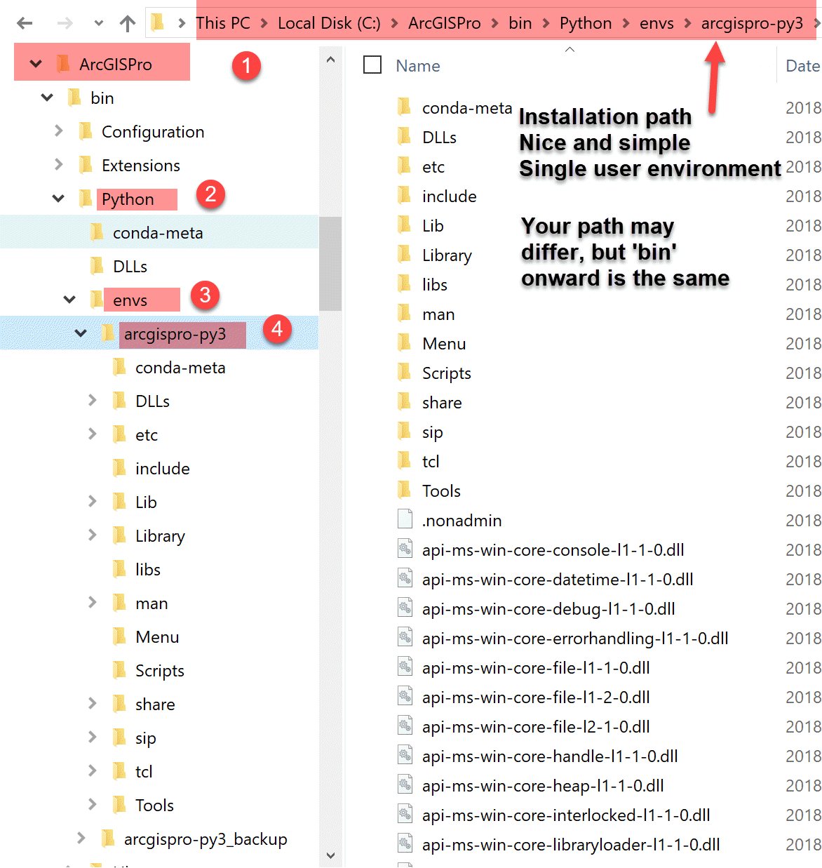

Onward.... find out where ArcGIS Pro is installed....

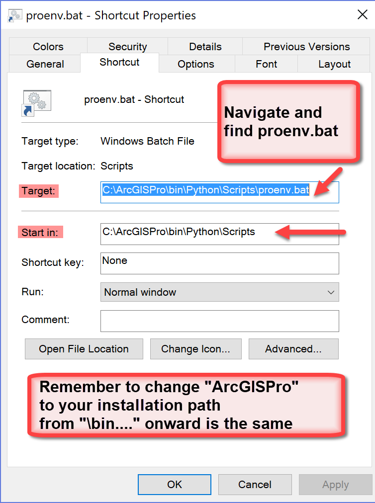

Conda access shortcut
Follow the path to the proenv.bat file located as shown in the following figure.
My installation path is C:\ArcGISPro\ You just need to change that portion in your searching and the rest will be the same.
When I located, the file, I created a shortcut and modified the contents of the shortcut as shown below. I then copied that shortcut to my desktop.

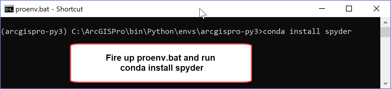

Yes... spyder is in the default package, but since the ArcGISpro-py3 environment is shut down, you have to do installs using conda..

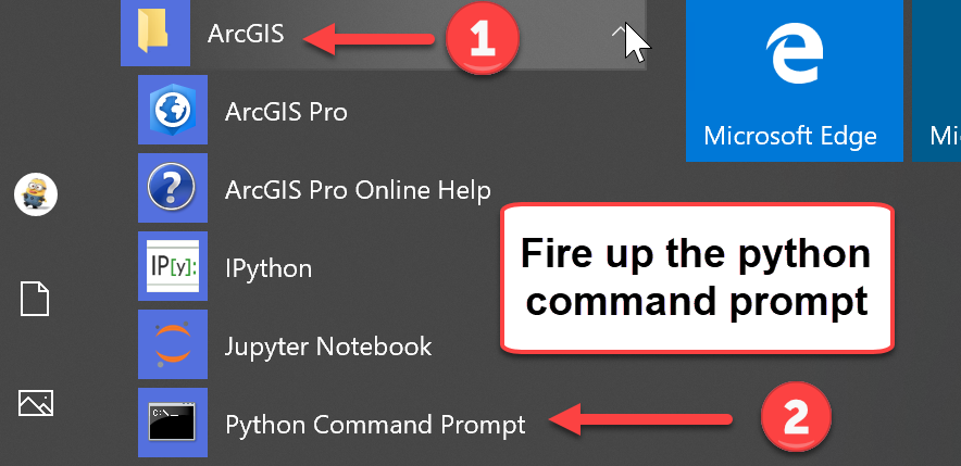

If you don't have a shortcut created... just fire up the python prompt
Or fire up your new shortcut and follow along

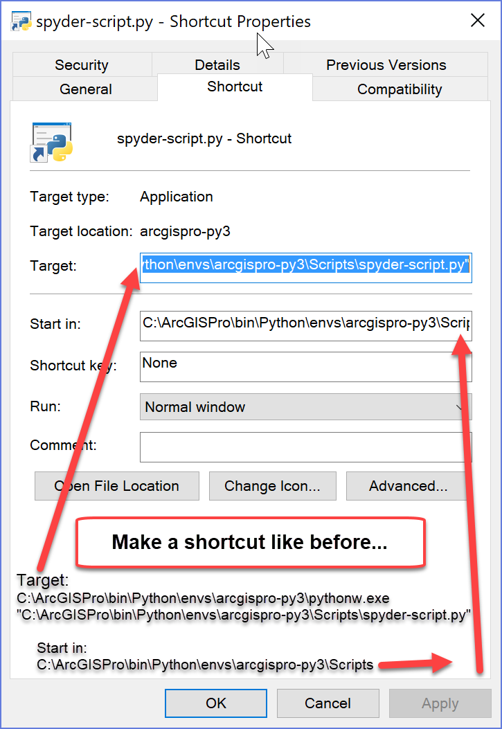

Navigate to C:\Your_Install_Folder\bin\Python\envs\arcgispro-py3\Scripts\spyder-script.py
and make a shortcut like...
Target
C:\ArcGISPro\bin\Python\envs\arcgispro-py3\pythonw.exe "C:\ArcGISPro\bin\Python\envs\arcgispro-py3\Scripts\spyder-script.py"
NOTE...
!!! if your default installation path has flotsam (like spaces, dashes and dots),
you may have to enclose both portions of the Target in double quotes. !!!!!

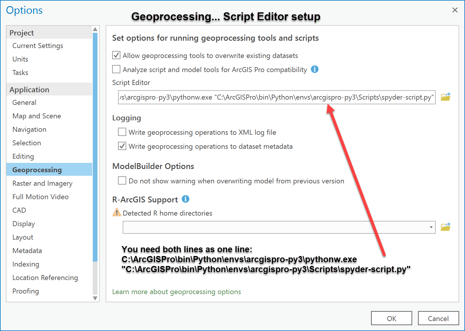

Setup Spyder as your script IDE
You get to reuse the Target shortcut used before.
Just remember
- the pythonw.exe and spyder-script.py paths below need to be on one line.
- if the python path is in a horrid space or flotsam filled path... enclose it in double quotes.
- always enclose the spyder-script.py path in double quotes
- Remember to replace C:\ArcGISPro with your installation path... everything else is the same
- This is your target path and it goes into the geoprocessing editor selection as below
- environment: C:\ArcGISPro\bin\Python\envs\arcgispro-py
Put them together....
env\pythonw.exe "env\Scripts\spyder-script.py"
Yields....

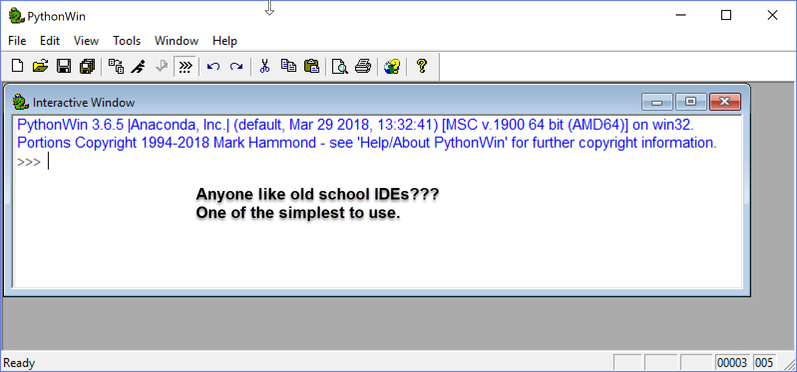

Of course you can always install and use Pythonwin for that easy-to-use Python IDE

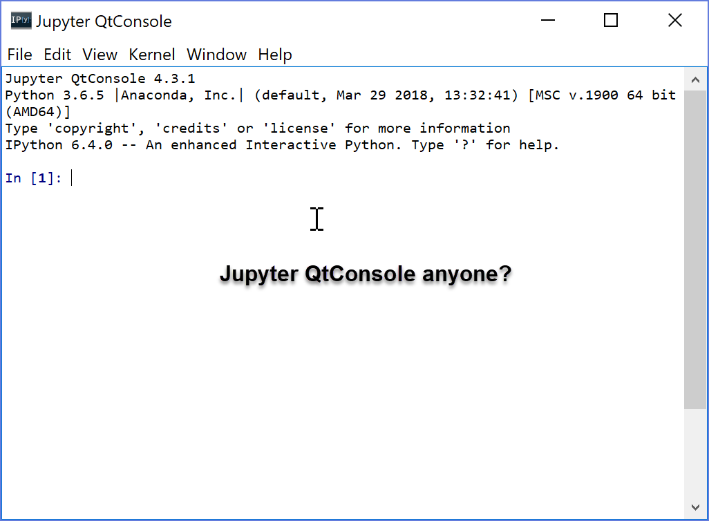

How about just a simple QtConsole for parallel IDEs

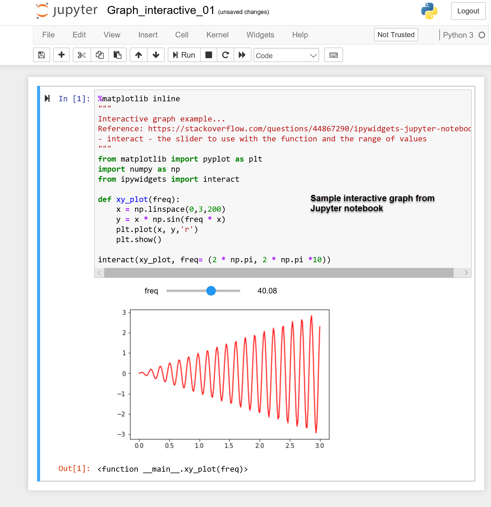

Jupyter Notebook... graphing, analysis and graphing...

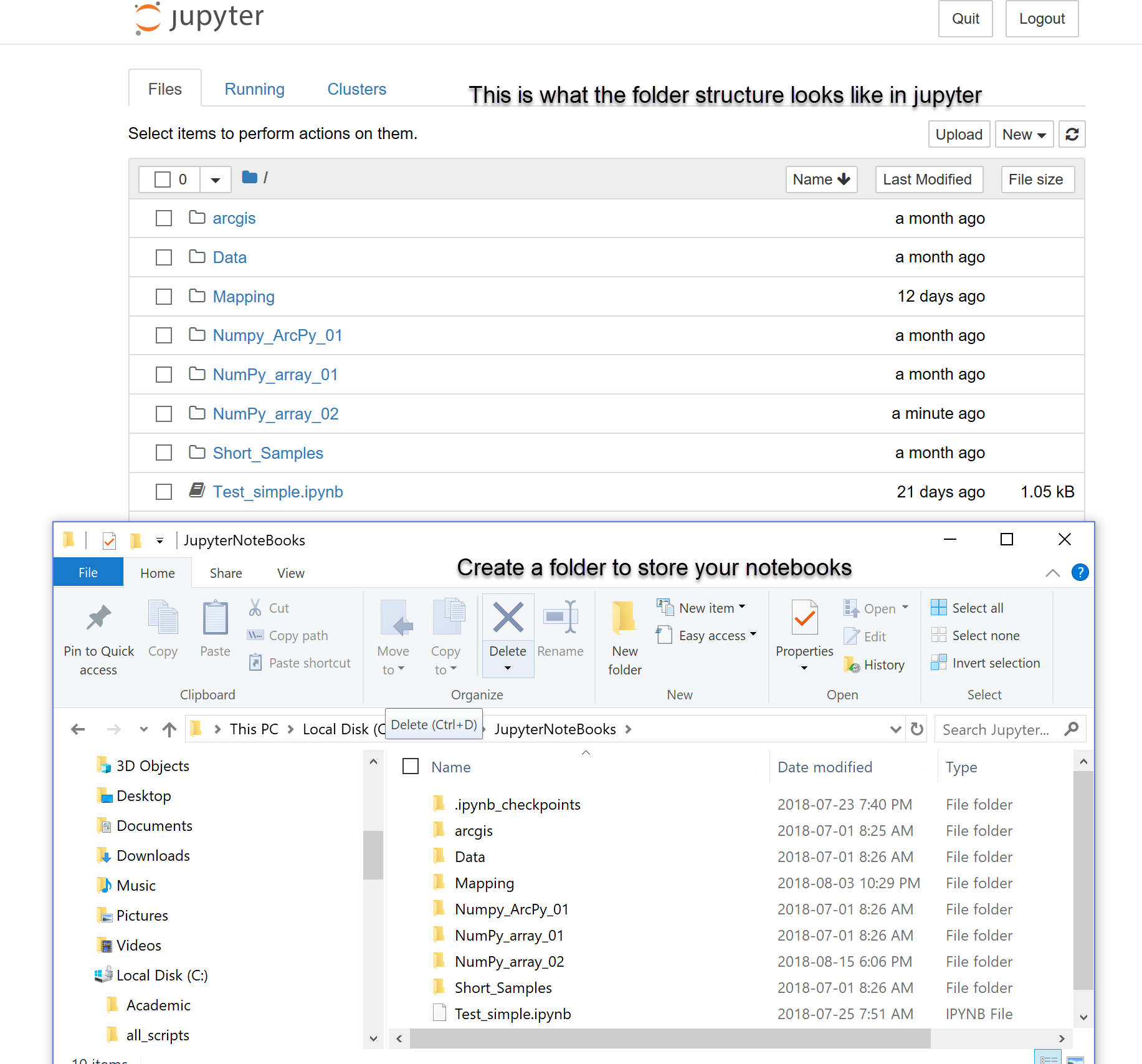

Just create a folder structure to store your notebooks and it can be replicated within the jupyter setup making it easy to find your examples.
A graphing example... there are lots

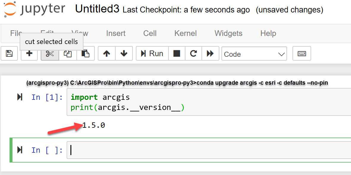

I just used conda to upgrade jupyter notebook and install jupyter lab. To stop it from trying to downgrade a bunch of packages, just add the default channel and --no-pin.

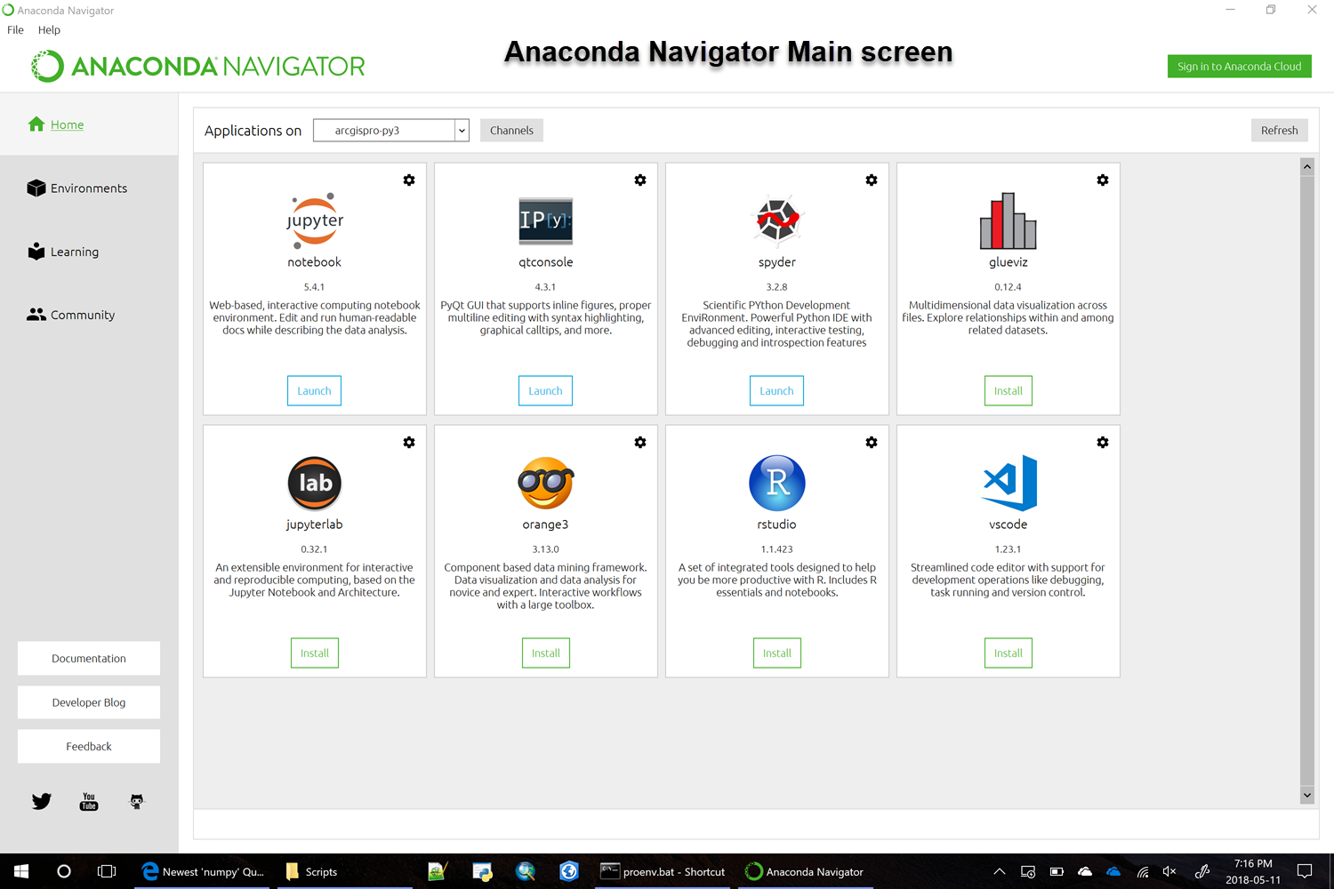

Anaconda Navigator
So very useful, since you can access other Anaconda packages through one interface... but currently not ArcGIS Pro, but many others including documentation and the like.
https://community.esri.com/ideas/14817-anaconda-navigator-to-arcgis-pro

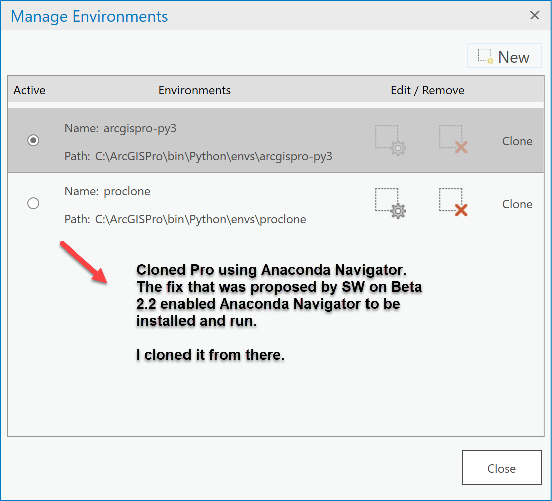

So... Once Anaconda Navigator got installed, I decided to see whether I could clone an environment that Pro 2.2 could see ... which seems to be an issue. It seems to have worked so far. Have a look
