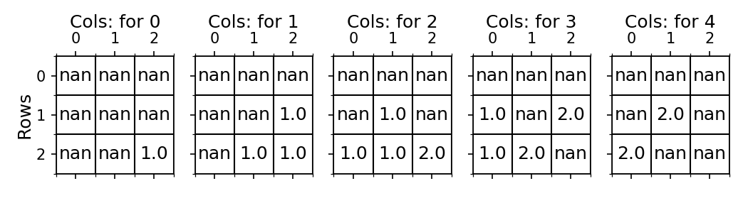

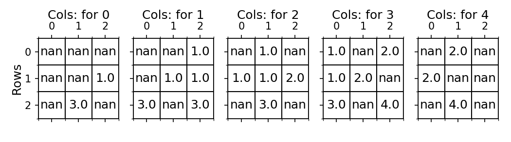

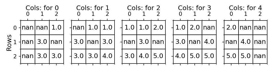

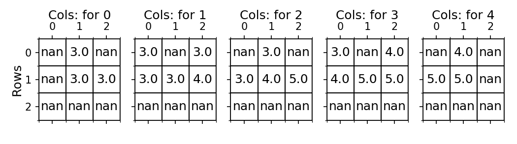

How about in pictoral form
Some people don't work well with numbers so have a gander.
Remember, we are simply sliding a 3x3 window over by 1 column until it hits the end of the row, then it drops one row and repeats. nan in both situations is Not A Number. There is Nan, NaT (not a time) but no Nai (not an integer). Integers require you temporarily upscale the data to floats, process, then downgrade... or use masked arrays or masked operations.
-----------> Sliding over one column at a time ---------->
Shift down a row
Again
And Again

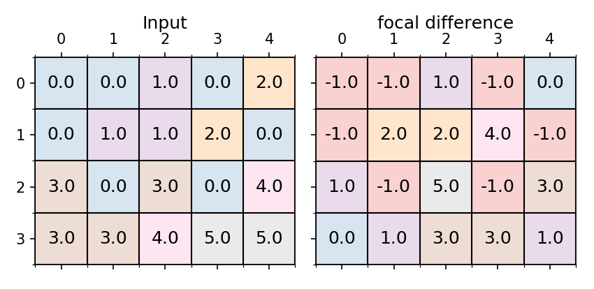

A hard one (sort of)
The difference of the surround cells from the core cell accounting for nodata and assigning nodata if the focal cell is nodata. In the original array, nodata was 0 and in the output -1 is used.

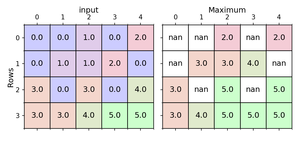

An easy one (the maximum)
The sample code that does the focal maximum. The padding and striding function can be found on the toolbox on the
ArcGIS Code Sharing site.
