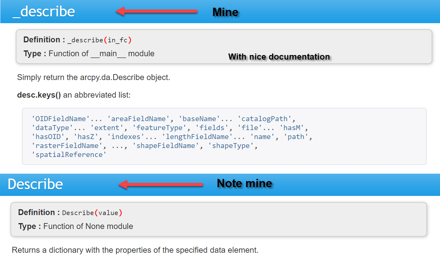

So simple, so... _common give it a try
More offerings in … npGeo ... numpy geometry
Oh yes... Nice documentation too...
