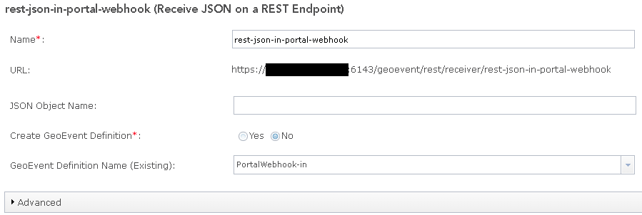

- Have the input create the definition for you, but name it something like "MyWebhookName-in-auto".
- After the definition is created by the input, make a copy of it.
- Name the copy something like "MyWebhookName-in" (take the "-auto" off)
- Back in your input, change Create GeoEvent Definition to No and select the new definition you just created.
