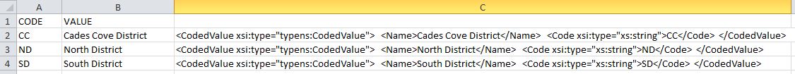

What I want to see is the values and codes sorted alphabetically, which they are not. First, a little Excel magic. Using the Domain to Table tool, I've exported the Domain out to an Excel Spreadsheet. Then performed my sort.
Then some field calculations. Here I'm using plain text for the XML element and cell references for the CODE and VALUE.
="<CodedValue xsi:type=""typens:CodedValue""><Name>"&B2&"</Name><Code xsi:type=""xs:string"">"&A2&"</Code></CodedValue>"
Note how the formula is all one line with no carriage returns. Otherwise when you paste the result, quotes will be added where you don't want them!
Now update the XML definition by pasting the Excel formula results to replace the XML elements (ONLY!):
