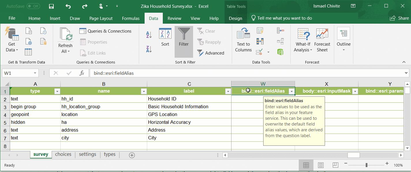

The next animation shows how you can access the data validation rules of a cell in Microsoft Excel.
Virtually every cell in our samples and templates has data validation. At this moment, I just want to make sure you know how to open the data validation rules for a particular cell.

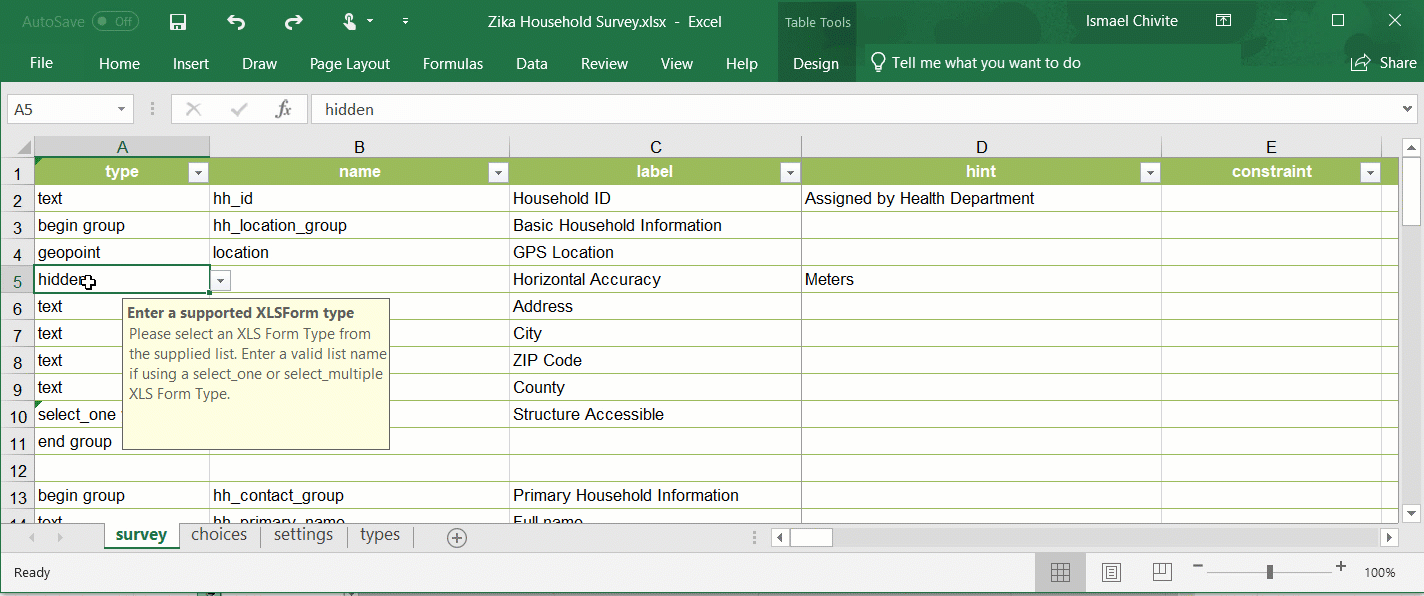

Yellow tips (and how to hide/disable them)

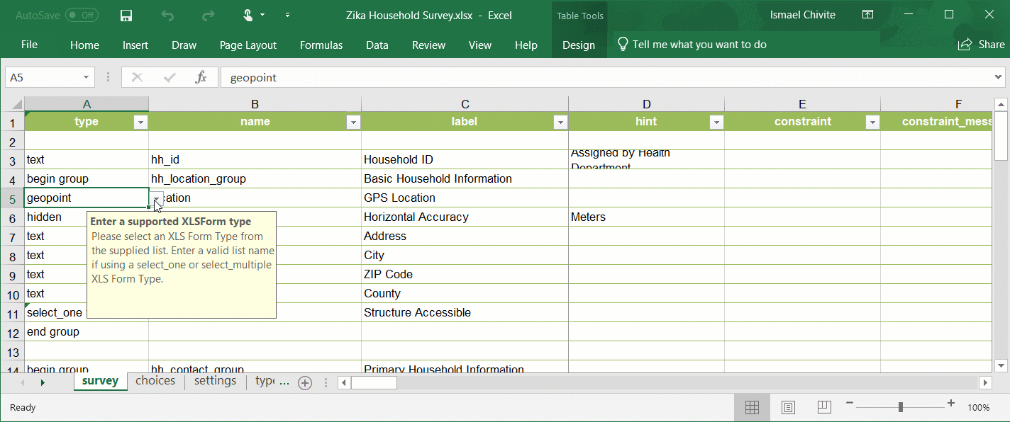

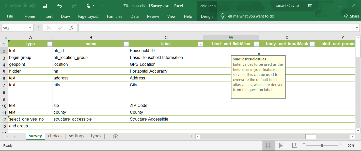

When you select a cell in the survey sheet, you always get a yellow tip. We added them to describe the purpose of the different columns in the survey sheet. Below is the tip for the bind::esri:fieldAlias for example.
The yellow tips provide good info, but they also can get on your way obstructing the view of your form design. If you simply hit the Esc key, the tip goes away until you select another cell.
The yellow tip, in Microsoft Excel jargon, is an Input Message. To disable it, you need to go into the data validation dialog as shown in the next animation.
If you feel ready for it, you can also disable all the Input Messages in one go. First, select all cells in the survey sheet using Ctrl-A, then open the Data Validation dialog and disable the Input Message for all.

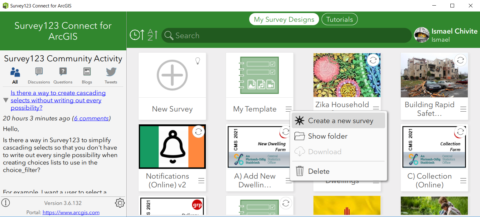

Creating your own template
By now you may be wondering if you can create your own template. To some extent, the answer is: yes. You can first create a new survey from the Advanced Template and make your own modifications to the Excel file. You can then use the Create a new survey option to derive new surveys out of your own template.
What I like about this approach is that not only you can create a new survey with all the modifications in your Excel file, your new survey will also inherit other properties of your template, such as the thumbnail, summary and description of your own template. Style, Inbox and Image settings in your template will also be matched, as well as custom content in your media folder if you ever add it to your template form.
If you publish your template from Survey123 Connect and share it with groups within your organization, other people will be able to use it too. Your survey, once published, will appear in the My Organization category of the New Survey dialog in Connect.

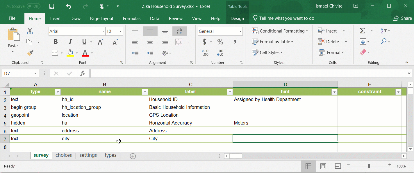

Inserting new rows, the quick way: Ctrl-Shift-+.
It is no secret that you can insert a new row by selecting a row, right-clicking and then using the insert option in the context menu. If you want to do that same thing much more quickly, select a row and then hit Ctrl Shift +.

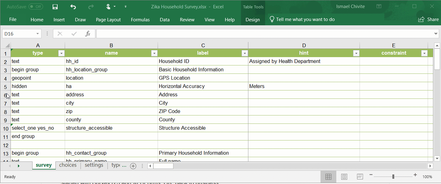

Careful with copy paste!
Copy-pasting is often our friend. Nothing wrong with it... unless you copy too much. In Excel, when you do a standard copy-paste, you actually are copying way more than you think: you are copying the cell values, but also formatting style and formulas. It is the formula bit that can get you in trouble, particularly when you copy cells from one xls file to the next. To avoid any issues, I like to copy just the values. This is described well in this Microsoft article.

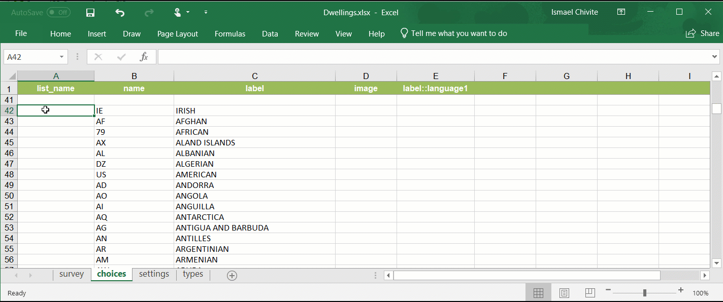

Extend values and formulas
This tip is particularly valuable when constructing lists in the XLSForm choice sheet. Simply double-click on a cell's bottom right corner to extend that value and formula down to the end of the list. In the animation below this technique is used to apply a list name to over 250 list choices.

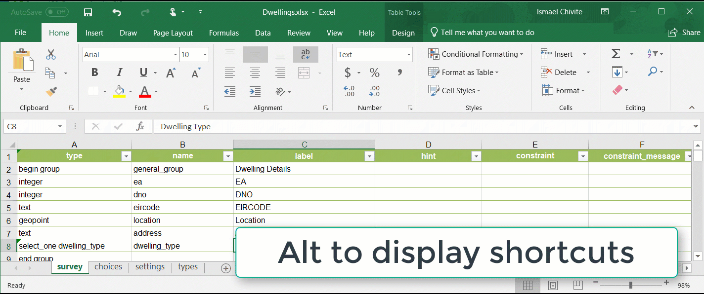

Keyboard shortcuts
In Microsoft Excel, using the mouse is often the slowest approach to get anything done. There are keyboard short-cuts for anything you can imagine. I use keyboard shortcuts for selections quite a bit: Ctrl + A to select all cells in a sheet and Ctrl + Shift + Down Arrow to expand a selection to the bottom of a list.
But there are way too many shortcuts to describe and only a few that you will truly take advantage of. If you hit Alt, Microsoft Excel will describe keyboard shortcuts to open a ribbon. For example, Alt + A opens the Data ribbon but you do not have to remember that, because if you simply hit Alt, the Data ribbon will be highlighted with A as a reminder. Even better, if you hit Alt + A not only the Data ribbon opens, but also every function within it is also highlighted with its shortcut. For example, Alt + A + V opens the Data Validation menu.
