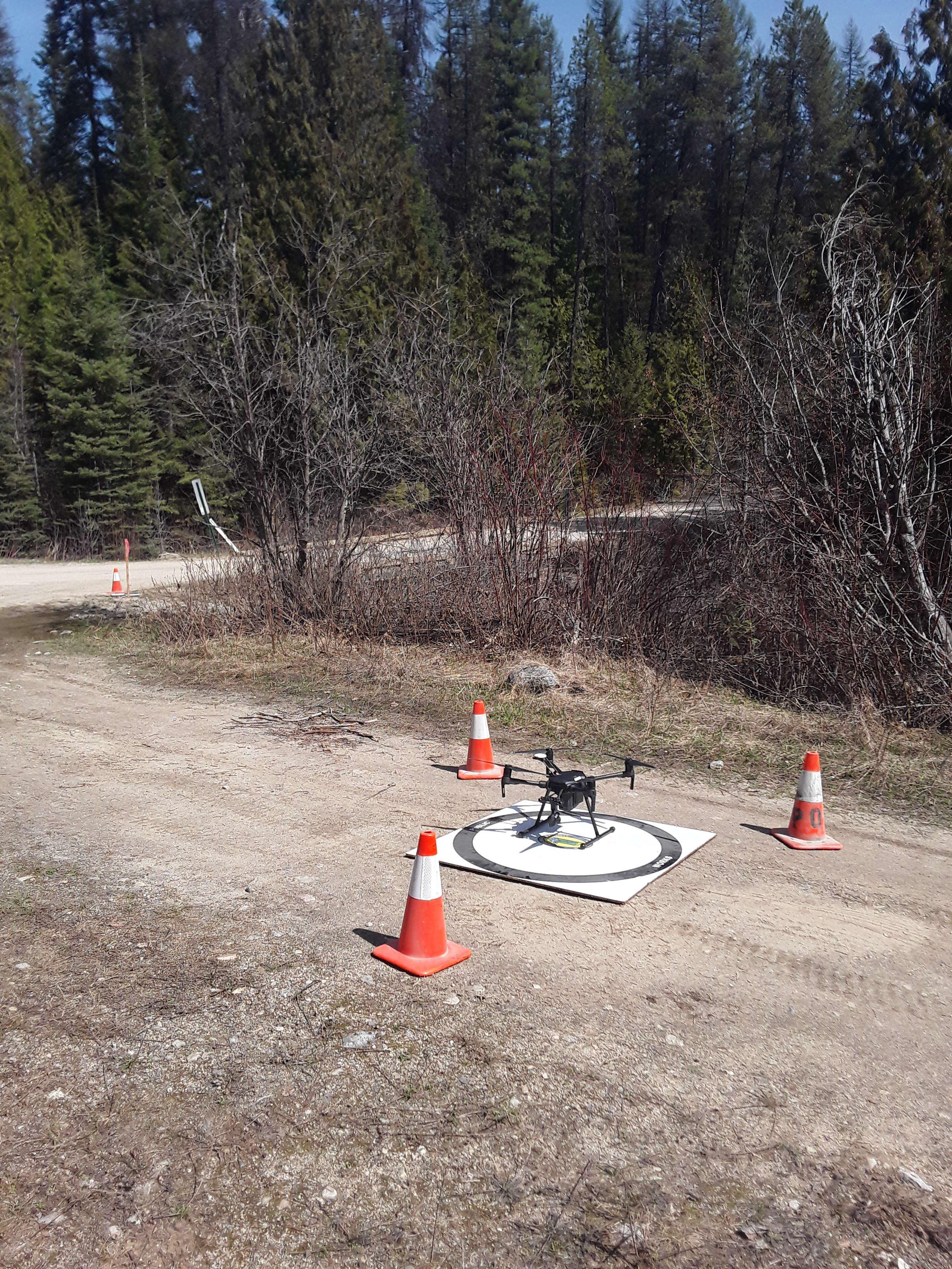

UAS launch site prior to flight
Eric Roth, Pend Oreille County

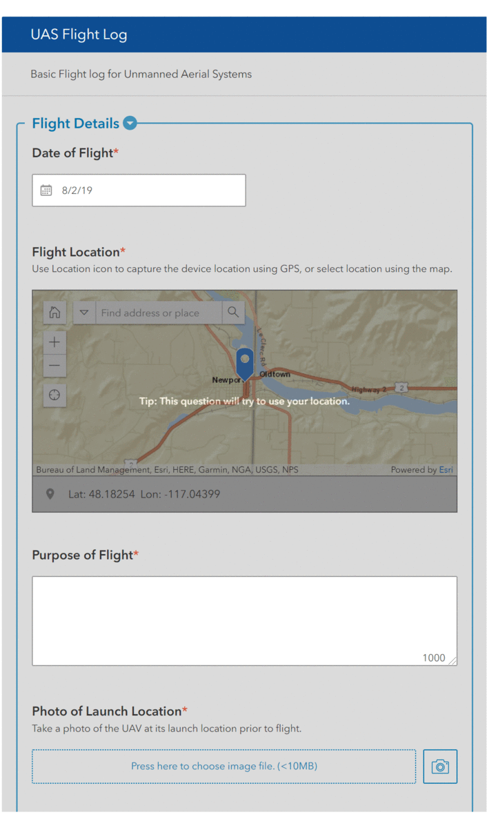

The survey was developed entirely using the Survey123 web designer at survey123.arcgis.com. The basic premise was to take the preflight checklists already being performed and recreate these in the survey. The added benefit here is that one could integrate post-flight observations as well as log our flight location and record the event with photos. The survey design is split into 4 logical sections:
Form Summary
- Flight Details – Here we record the following:
- Date of capture – This auto populates further simplifying the process
- Location – Uses device GPS to provide location or the user can select from the map.
- Purpose of flight – Comment field allowing for a customized description
- Photo of the UAS at the launch location – This helps to prove project location and UAS used, as well as the condition of the launch location
- Weather conditions – Comment field for customized descriptions
- Name of RPIC (Remote Pilot in Command) – Comment field for customized entry
- UAS pilot name, if different than the RPIC – Comment field for customized entry
- VO (Visual Observer(s)) names, if applicable – Comment field for customized entry
- UAS Details – Here we record the Make and Model of the UAS.
- UAS Manufacturer – prepopulated dropdown containing the manufacturer of the UAS being used
- UAS Model – prepopulated dropdown containing the model of UAS being used
- Pre-Flight Check List – This is a simple check list where the following items are “checked off” as they are inspected:
- Batteries charged and secure?
- Aircraft Hardware OK?
- Equipment & Gear OK?
- Remote Control OK?
- Propellers OK & Secured to UAS?
- Software & Firmware Versions Up to Date?
- Remote Control is Powered ON?
- UAS is Powered ON?
- UAS Compass is Calibrated?
- Camera is ON & Calibrated?
- UAS GPS is Functioning?
- Flight Control App is Running & Connected to UAS?
- Pre-Flight Notes – Here any ancillary information can be noted
- Post-flight details – here we record flight start/stop times and note any post-flight observations
- Begin Flight – record the time the flight began
- End Flight – record the time the flight ended
- Post-Flight Notes – Records any additional observations

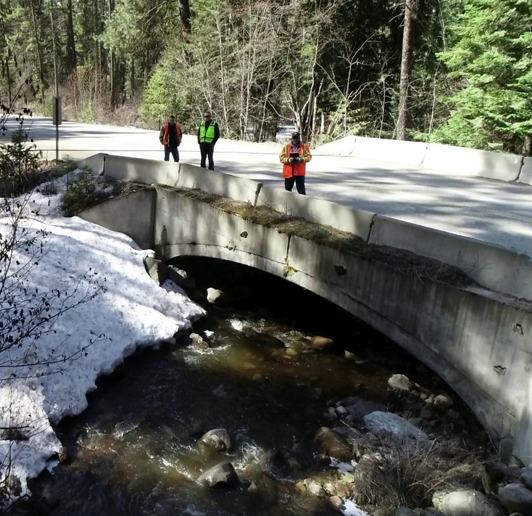

Using UAS for road and bridge inspection
