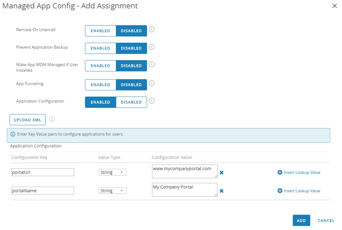

Managed app configuration allows apps to be remotely configured through an EMM solution. In order to use managed app configuration, the app must be installed on the device and managed via an MDM solution. While managed app configuration is a feature supported by most of the popular MDM providers, it's best to check with your provider if this feature is supported.
In general, MDM providers support AppConfig using key-value pairs. In AppStudio we are following the guidelines found within the AppConfig community's xml standard specification for iOS, Windows, MacOS and Linux. On Android, we support Android's Restriction Manager xml spec.

Below is an example of how to set the key-value pairs when creating an assignment, from within the VMware AirWatch MDM console:
