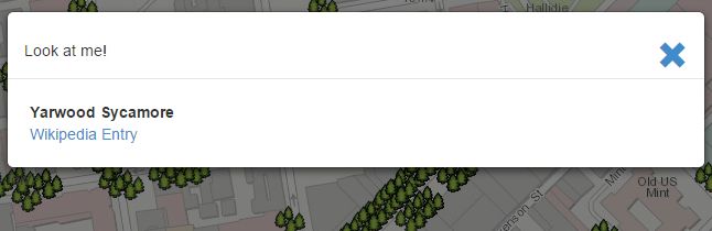

The result will look similar to this.
To demo this, I just took an existing InfoWindow sample and modified it in this JSBin.
Dojo Bootstrap Sample
There's not much happening in that Modal window, but think about what you could do with that extra real estate. You could display image attachments, or provide nicely formatted details of the data or related table data. You'd have room to even add other widgets in there to display nice charts in the window. I use this to provide full edit forms with nice big buttons and even other Modal popups as picklists. The power is in your hands.
