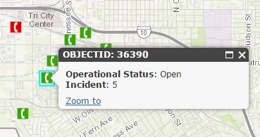

So you're chugging away at your awesome ArcGIS JavaScript application. You have some nice custom tools in place, you may even have some search capabilities going on, this thing looks cool. You go to click on a feature on the map and you've got all the important field information... except that you have numbers where maybe values should be showing up?
Well that the heck is that all about? What does that number even mean? So you go and look at the map service and you see that this field has a domain associated with it. Maybe you look at another application where this service is edited and you notice that the attribute inspector in the editor has the correct domain values and now you're just scratching your head wondering how to get those values. Don't worry, they're there...somewhere.

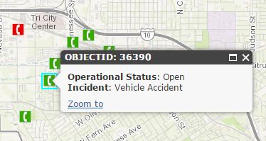

}So in this sample, we use Object.keys (note - you may need to shim this method) to get the keys of the attributes. You can use the keys to get the matching set of coded and domain values, along with the alias for the field, and compose a simple DOM element to display in the InfoWindow. The result of this technique now display the InfoWindow like below.
