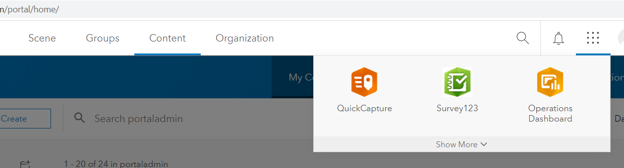

While you can obviously bookmark the URL above to reuse it, it is much better to modify your ArcGIS Enterprise app launcher to include a shortcut to the Survey123 website. That way, anyone in your organization can easily access the Survey123 website without having to remember the syntax of the URL.
You will find step by step instructions to create your own Survey123 website shortcut in the app launcher of ArcGIS Enterprise in this Technical Support Article.

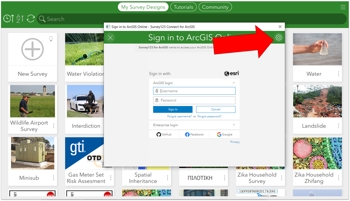

Survey123 Connect for ArcGIS
By default Surey123 Connect is configured to work against ArcGIS Online, but you can click on the settings button as highlighted in the next screenshot to add a connection to your own portal.

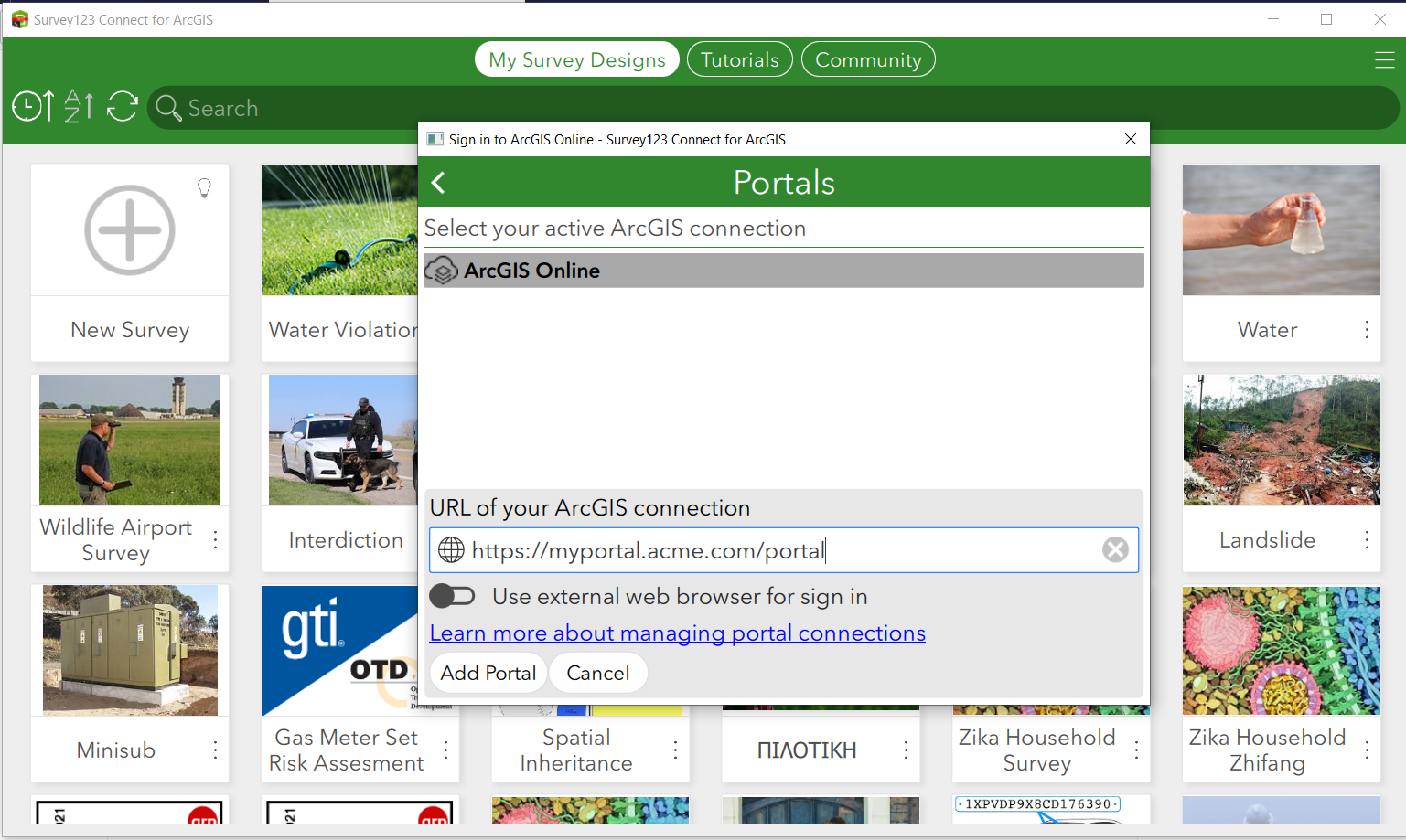

Clicking on the settings will allow you add the URL of your own Portal for ArcGIS. Just a couple of tips:
- Make sure you always use the https protocol.
- Do not forget to include the instance name of your portal. For example, below the instance name of my portal is ‘portal’, but by default the instance name is ‘arcgis’. You can really choose the instance name of your portal to be whatever you want… this is done during the installation of the ArcGIS web adaptor.
