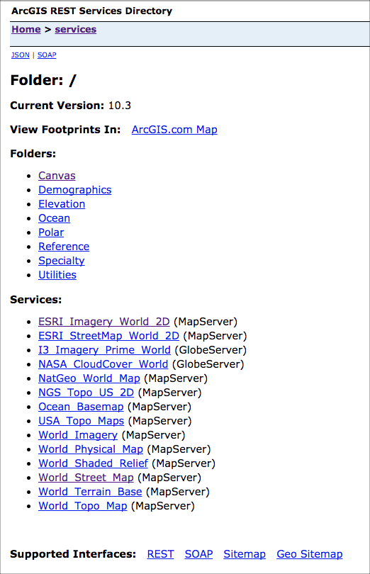

How do you get a map?
If you don't have your own Map Services and you just need a simple map, you can just use the ArcGIS Online basemap services. Here you will find an assortment of hosted basemap services that you can export maps from. Feel free to browse all of the map services and parameters and pick the ones that best suites your needs.

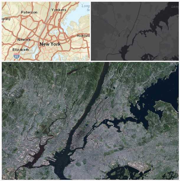

Simple Example
Here's a simple HTML example that shows how to use the REST API to fetch a few different maps. The nicest thing about making the REST calls directly is that you aren't dependent upon a client-side library and it makes it easy to build into existing frameworks or enterprise systems. All you need to be able to do is execute an HTTP request.
