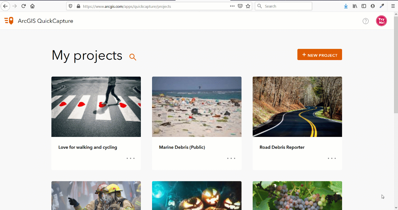

How can I visualize all data captured from QuickCapture in a map? Simply bring your QuickCapture feature layers into a web map. You can optionally set a refresh rate on your web map layers so new data will appear automatically as it gets submitted to ArcGIS. Even better, once you have your web map ready, bring it over into an Operations Dashboard or Web AppBuilder web application to deliver the best experience.
The animation below shows how you can bring your QuickCapture feature layers into a web map to get started.
