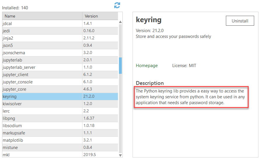

Option 2: Directly access keyring to store your password
Keyring is installed in the ArcGIS Pro default Python environment and can be used to securely store a password in the operating system's password manager.

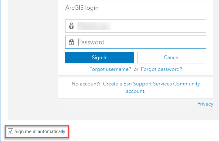

Option 3: Use the active ArcGIS Pro connection
Connecting to the GIS using the active ArcGIS Pro connection is also covered in the API Guide. No credentials are required; you just need to make sure ArcGIS Pro is on your machine and you are connected to the intended ArcGIS Online organization. The really advantageous part about using the Pro connection is that it works with SAML logins; so if you need to automate a script that requires authentication and don't have/do not want to use built-in users, this method is the way to go. To leverage the Pro connection without ArcGIS Pro concurrently running, you'll need to select "Sign me in automatically" when connecting to organization in ArcGIS Pro or take your license offline.
