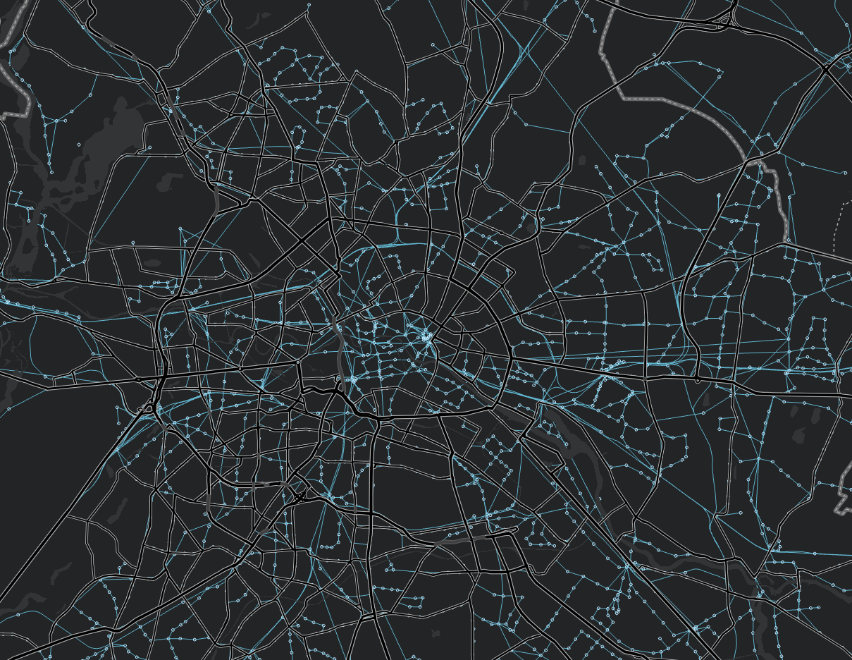

I started off by downloading the Display GTFS in ArcGIS Toolbox that Melinda Morang created. Using this tool, I was able to visualize my GTFS open data and discover the public transportation network and stations from Berlin and the surroundings. Given a geodatabase path, all you have to do is run the scripts and it automatically creates feature classes for both transit routes and stops.

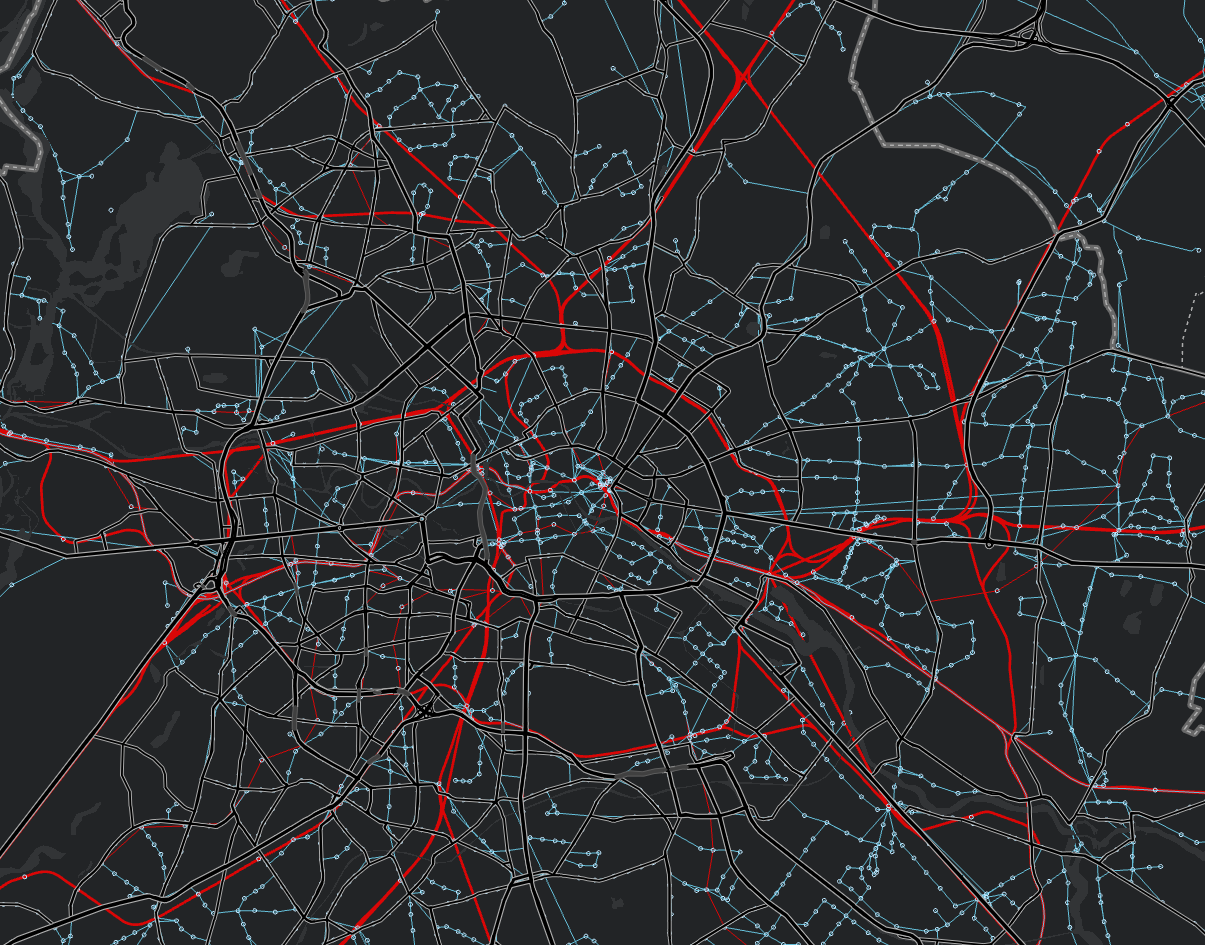

To better understand my data, I categorized my transit shapes based on the type of route (e.g. bus, tram, metro).

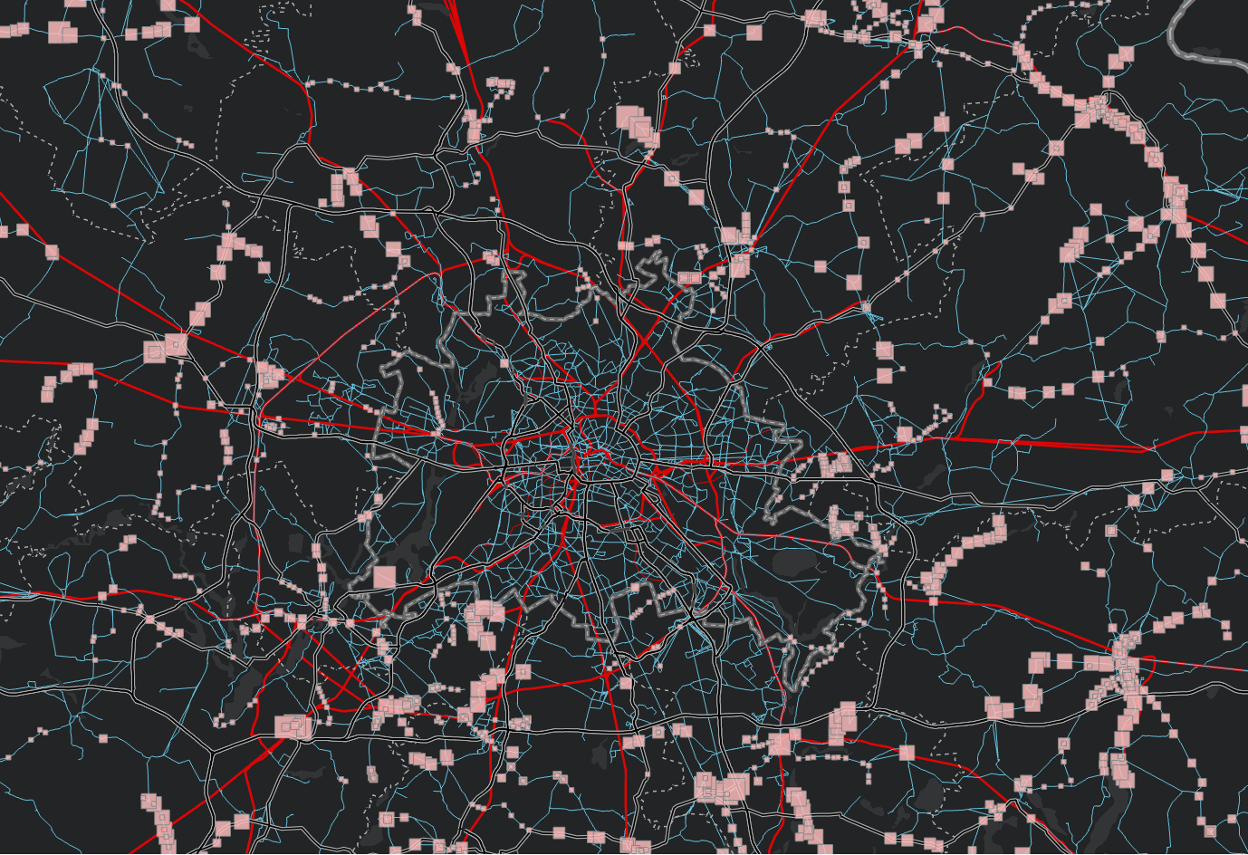

But this level of insight was not quite enough, so I decided to use some more tools Melinda developed. After downloading the BetterBusBuffer Toolbox, I ran the Count High Frequency Routes At Stops Script and got some amazing results. In the picture down below, the rectangles represent the trip frequency per hour for a typical Monday morning.

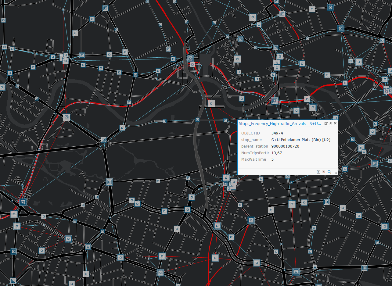

To get a better understanding of the waiting times at the bus and train stations in Berlin, I just adjusted the symbology to MaxWaitTime. I then blended out the stops where the waiting time was greater than 60 min. and got the following results:
As you can see, inside of the MP of Berlin, there are no rectangles. This means that the next step in analysis should focus on reducing the waiting times in the rural areas around Berlin, for the public transportation segments going to downtown Berlin.
