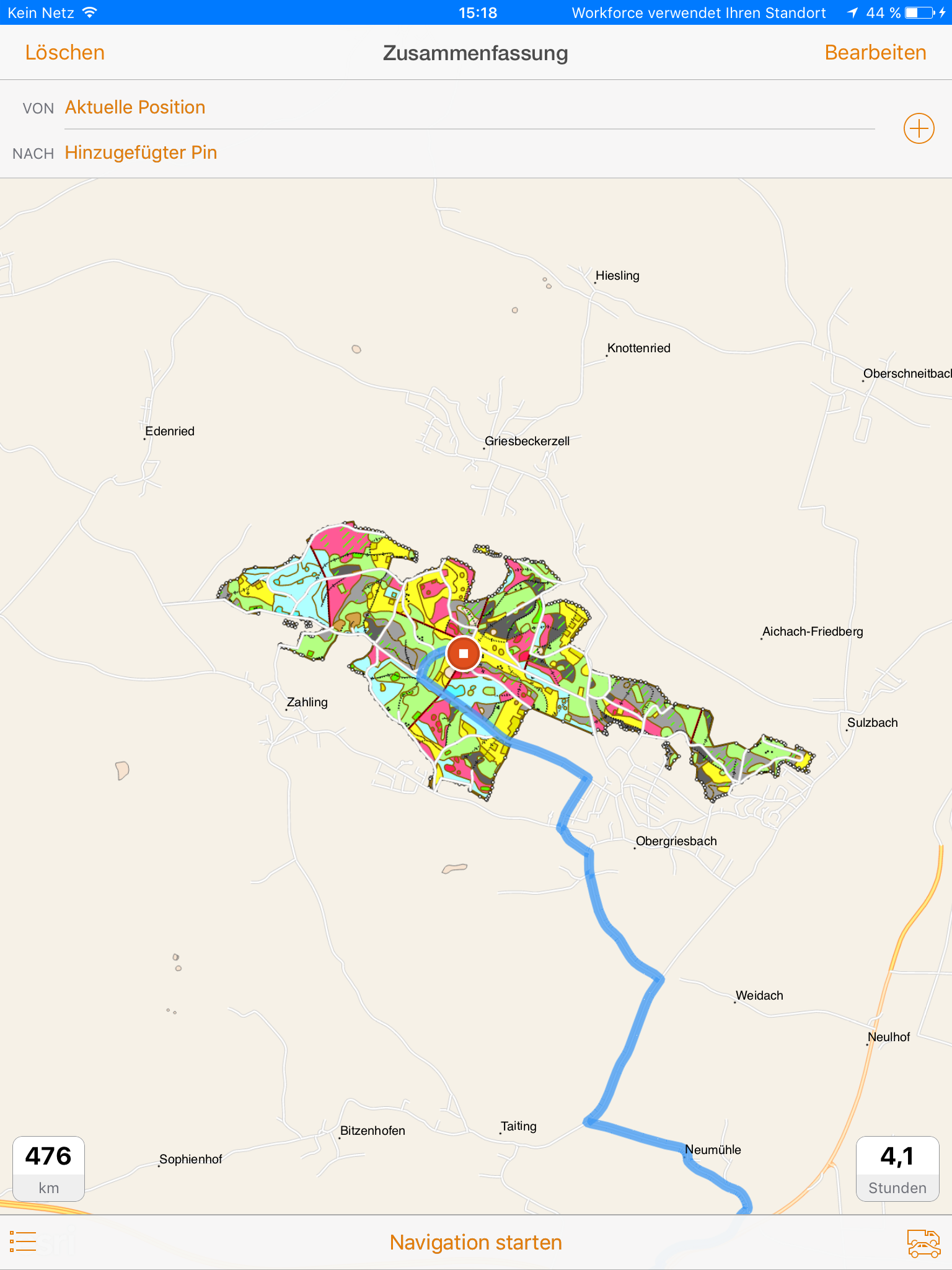

Mobile Map Packages with OpenStreetMap and Private Assets
Navigator for ArcGIS with OSM
OpenStreetMap (OSM) data is available free of cost and of quite good quality. The creation of an appealing map, the implementation of a suitable address locator and a road network for routing requires some efforts, though.
Initially, all data must be prepared for usage with ArcGIS. The map and road network can be created using the ArcGIS Editor for OpenStreetMap. This free and open ArcGIS for Desktop add-on allows for the filtering of raw OSM data to gain the required information, and the extraction into an ArcGIS-compatible format. The next step is the design of a visually appealing map (this part can be a challenging task for non-cartographers) and the creation of a routing network. The road network can be extended with private assets. In this example, a polyline feature class of forestry roads and another feature class of connections between public and forestry roads (so-called "transitions") are added to the network. The transitions have to be created manually using the Snapping tool (snapping public to forestry roads) and are then stored in the feature class. After reprocessing the network, it is possible to leave the public roads and navigate on the forestry roads. Network quality and performance are influenced by applied rules and attributes. And this is where the actual work starts: Cul-De-Sac rules, speed limits, U-turn policies, special walking, driving, or trucking routes—just to name a few—can be configured.
Finally, a suitable address locator is required, a rather laborious task. To configure the locator, cities, addresses, POIs, and their coordinates have to be extracted from the OSM data. The locator is then created with the appropriate ArcGIS Pro or ArcGIS for Desktop tools.
After importing the ArcGIS for Desktop project (.mxd) into ArcGIS Pro, the Create Mobile Map Package is run to create the MMPK that is based solely on OSM data.

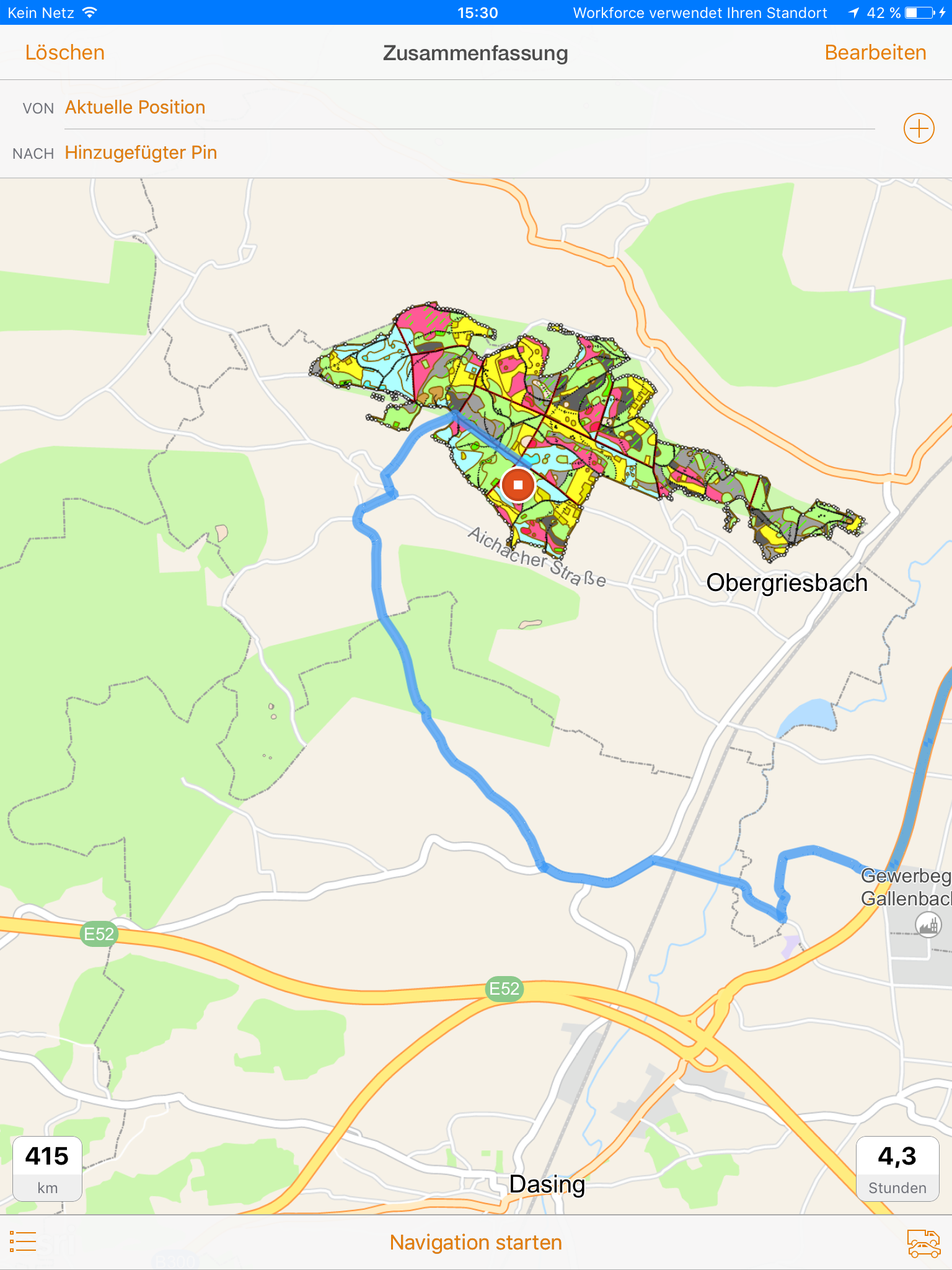

Mobile Map Packages with StreetMap Premium for ArcGIS and Private Assets
Navigator for ArcGIS with StreetMap Premium
StreetMap Premium for ArcGIS is a data package that is subject to cost (one-year subscription) and is based on HERE data (formerly NAVTEQ). The StreetMap Premium portfolio provides everything that is required: global dataset with appealing maps for day and night time, locators for individual countries, and a road network with almost perfect rules. StreetMap Premium includes an ArcGIS Pro project that can be used very easily and without much additional effort to create mobile map packages.
In addition to that, StreetMap Premium provides the option to extend maps and road networks with private assets. To learn more about extending the road network, please check this tutorial.
Note: The tutorial describes the steps to add individual roads and streets manually. Usually a feature class with this data - forestry roads in our example - already exist. In this case only the transitions have to be added manually. Next, the data is imported into the appropriate StreetMap Premium feature class "Custom Streets" and adapted to the target schema (attributes). This can be done with the Append geoprocessing tool in ArcGIS Pro. Finally, the required attributes like STREET_NAME or Paved are adjusted for accurate processing of routes and directions. Various tools or Python can be used for automating this step.
