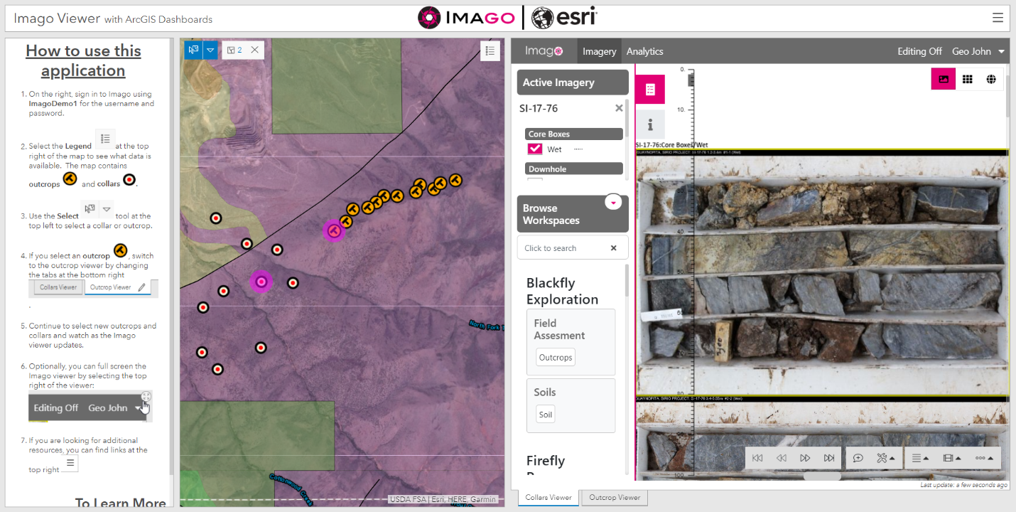

In this blog, I am going to show you how to access Imago images from an ArcGIS Dashboard (like the below image) so that you can dynamically select outcrops and collars on the map to view in Imago.
(View this dashboard)

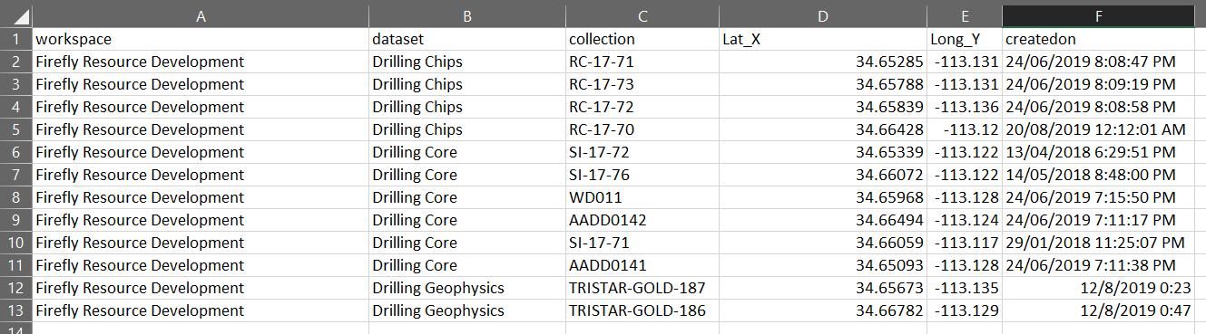

First, it starts with creating data in ArcGIS Pro. To do this, I had spreadsheets (attached to blog) for collars and outcrops which had latitude and longitude as well as a collection identifier field from the source data. The collection ID field will be used to query the Imago API. I used Excel to Table and XY Table to Point to plot the locations on a map in ArcGIS Pro.

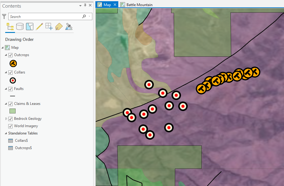

I then applied symbology for the outcrops and collars and added additional data layers to give extra context. With my map created, I shared it with my ArcGIS Online/ArcGIS Enterprise organization. For more information on how to do this, see this tutorial: Share a web map.

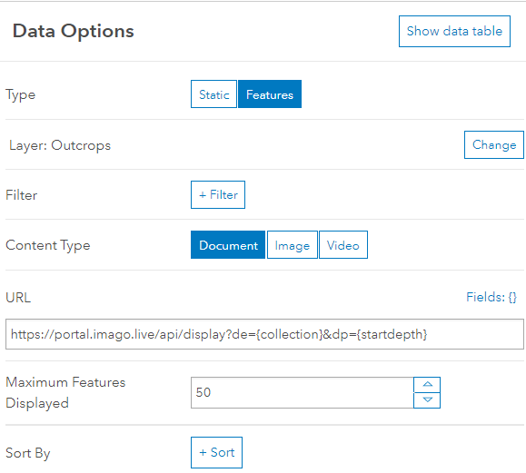

- Create an “Embedded Content” element
- For “Type”, choose “Features” and select either your outcrops or collars feature layer.
- In the “URL” section, construct a URL using the fields. All of the URL’s have the same structure and contain two parameters, one for the collection identifier and one for the depth, which are both fields in our feature layer. Here is a sample URL with the parameters highlighted: https://portal.imago.live/api/display?de=20180717&dp=3
To build your URL, start with “https://portal.imago.live/api/display?de=” and then select from the field's drop-down the “collection” field. Follow this with “&dp=” and finally the “start depth” field, or just the number “0” for collars, which do not have a depth.
