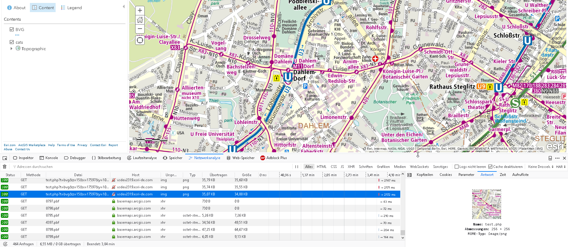

The parameters are send to the PHP-enabled server using the following schema:
http://your-server-URL.com/name-of-your-script.php?z={level}&x={col}&y={row}

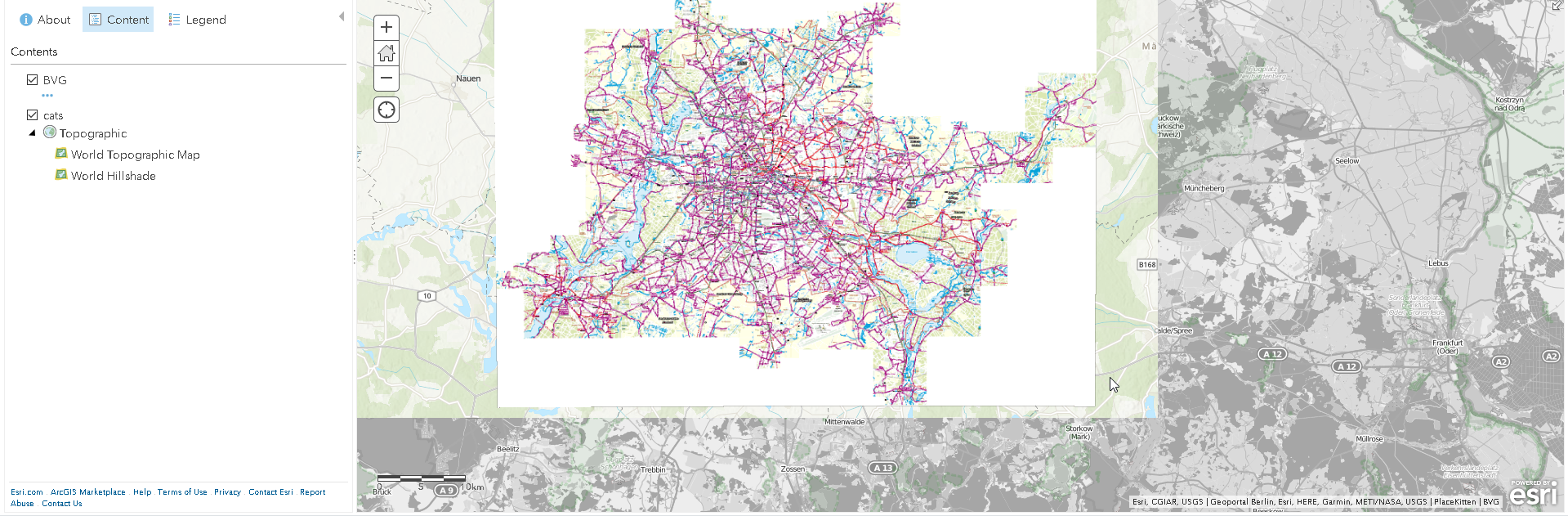

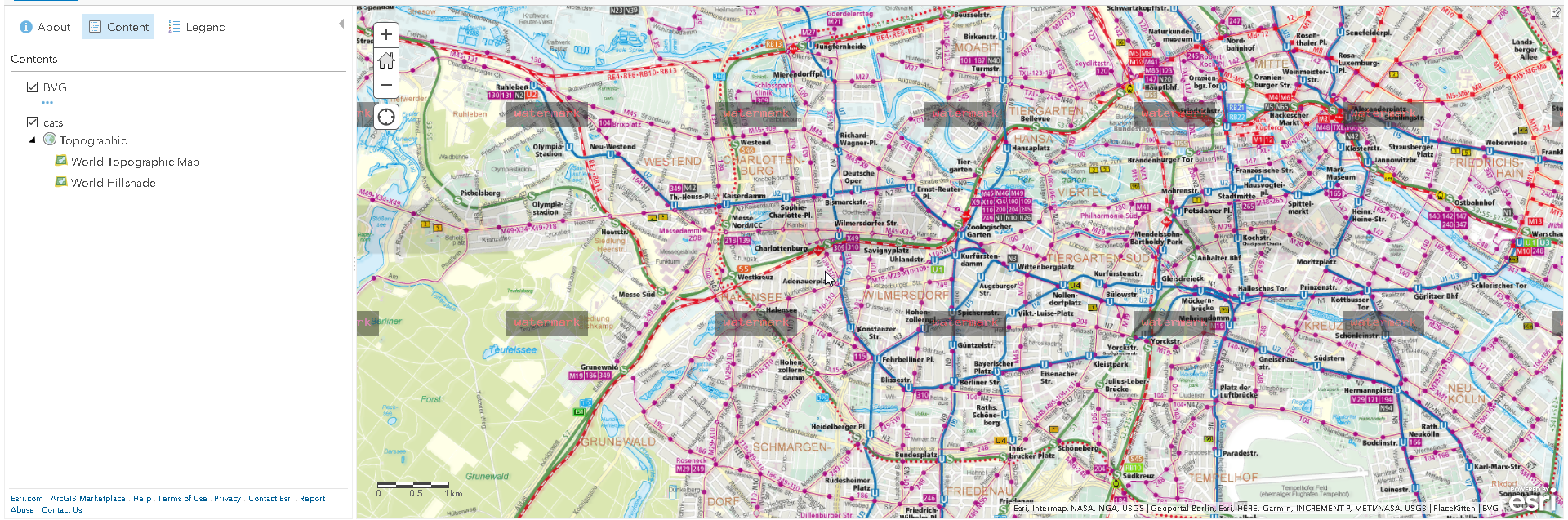

Using this script you will get a nice BVG basemap in your ArcGIS Online editor Map Viewer:

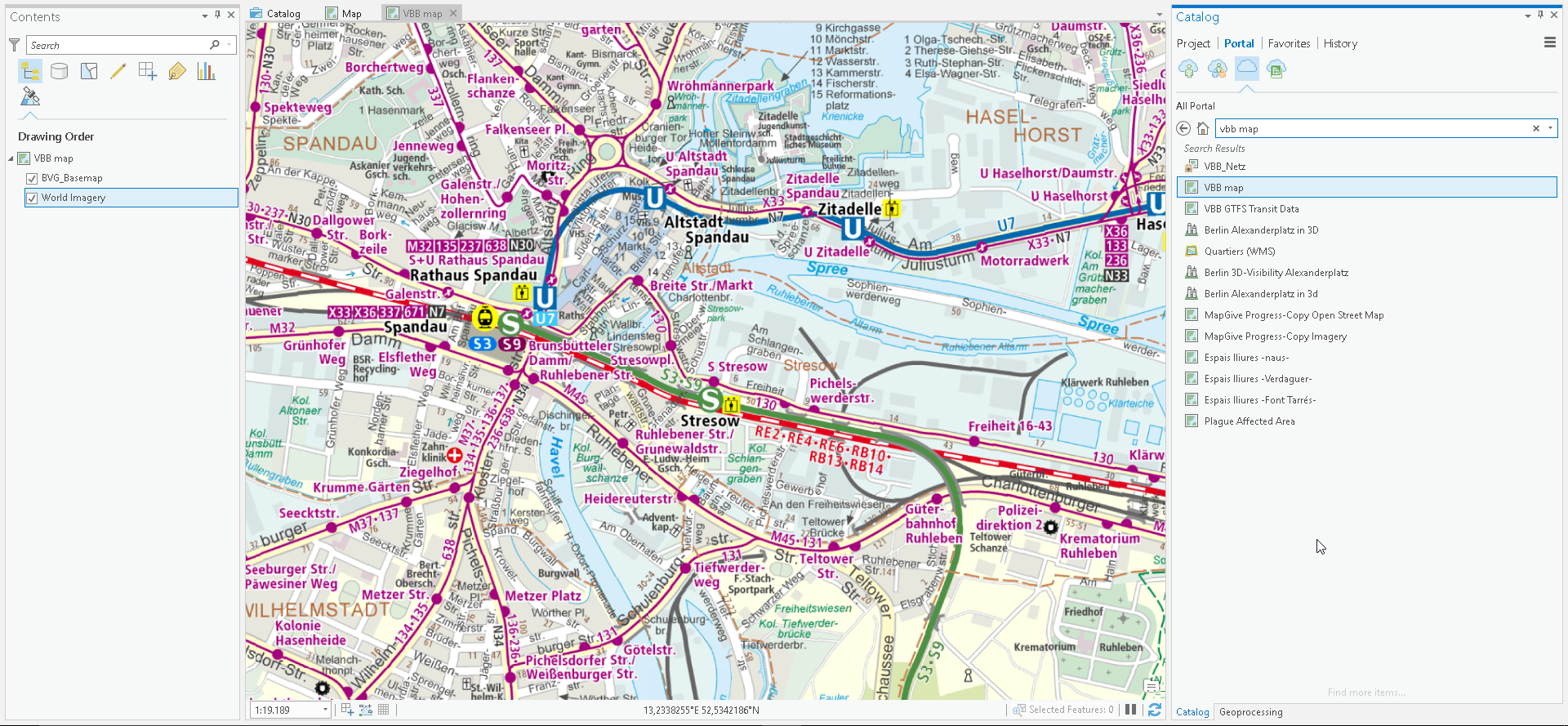

Once you saved the web map you can even open it in ArcGIS Pro and use it for your purposes by adding the map from Portal:
