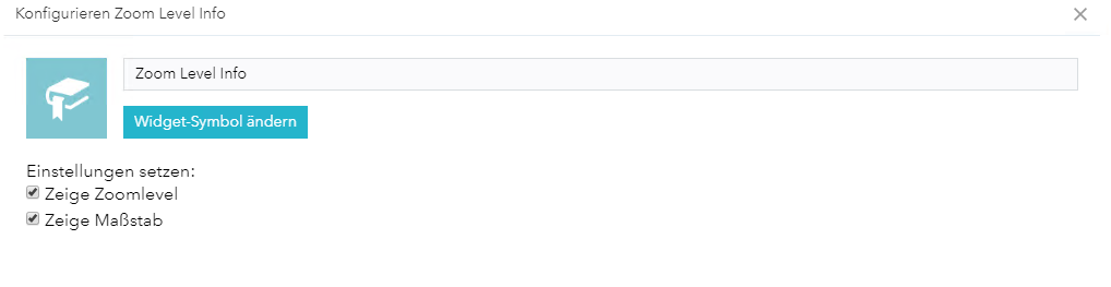

The widget is now able to start in English as well as in German depending on the settings in the Portal:
