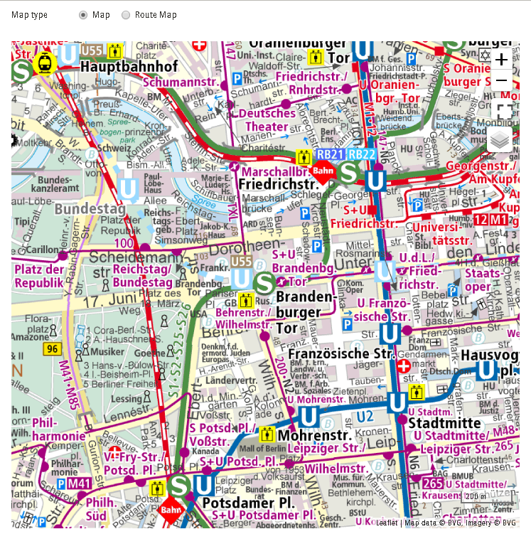

I like to explore the city via public transport and as I am a big map fan, I fell in love with the map of our Berlin based public transport service provider BVG. The map is a great product and has so many levels of information. It has a well know style established in Berlin so I wanted to use it in my own web mapping application.
As I scanned the website of the BVG I noticed the leaflet map on their page:

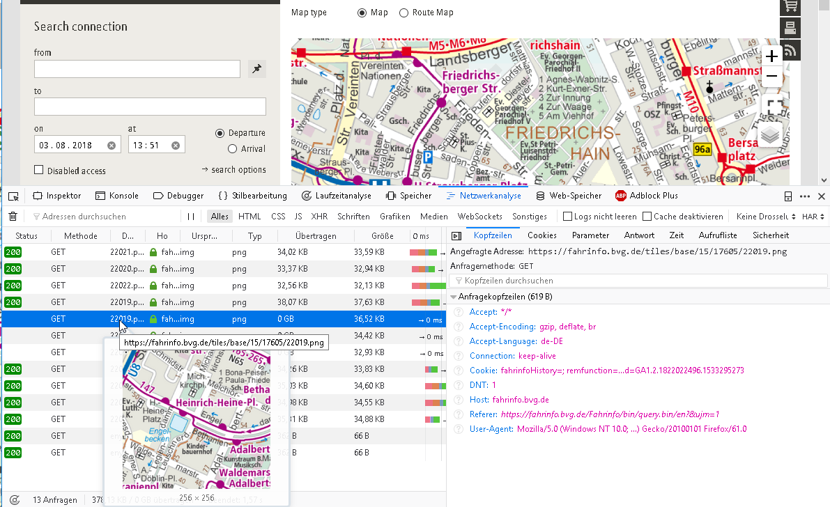

So I asked the question: "Where does the tiles came from". A short look in the network developer pane in firefox revealed the address https://fahrinfo.bvg.de/tiles/base/15/17605/22019.png (example)

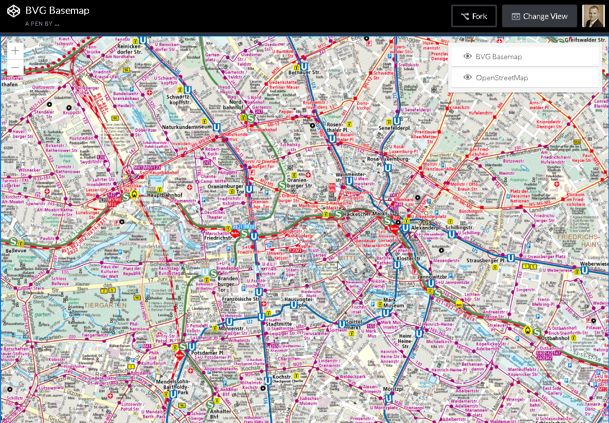

So now we need to import this logic into the method ArcGIS uses to get the tiles. And BAMM: here are the tiles:

Explore the webmap on CodePen, or download it below.
And last but not least: You can even rotate it:
