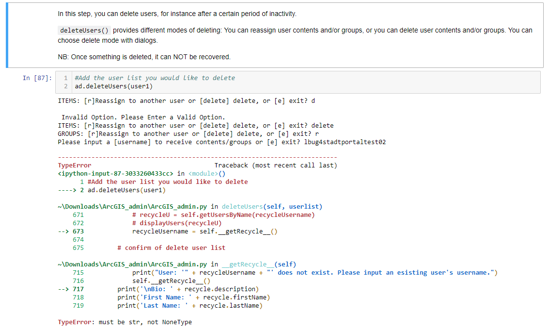

1. Deleting User
Deleting Named User fails if a user has one or more licenses assigned, to ensure deleting works without any problem, programmers are reminded to always revoke licenses before deleting users. Exceptions should always be handled correctly, exceptions invisible to the user may also prevent scripts from working correctly. Sometimes missing attributes like biography-description-texts can lead to malfunctioning of scripts, it is always suggested to use if-else-queries to prevent accessing attributes, which are missing.
Deleting Named User from ArcGIS can be safely performed if the user:
- Has no licenses assigned
- Missing properties (e.g. biography-description-text) for users are properly handled
- Unimportant exceptions are properly handled

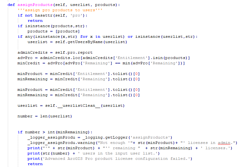

2. Assigning Licenses
Assigning licenses to Named User fails if users are not entitled to use the requested license. If licenses are not available in the user’s organization, but are hard-coded and therefore required for every user, a exception may be raised if licenses are not available in some organizations. Invalid licenses as well as a missing count of licenses also prevent programs from running correctly. If-else-queries help to avoid running into problems and notify the user of invalid arguments. Exceptions should always be handled correctly, exceptions invisible to the user may also prevent scripts from working correctly.
Assigning Licenses to users in ArcGIS works flawlessly if:
- The user has the rights and is entitled for the requested license
- The requested license is available for the user’s organization
- The requested license is a valid license
- Enough licenses are available
