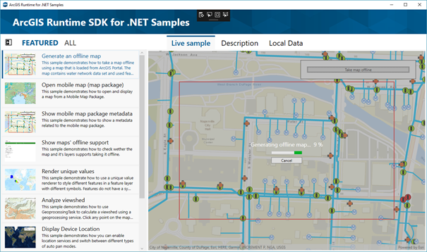

The step-by-step implementation of an OfflineMapTask is described in the respective documentation of the various ArcGIS Runtime SDKs, here for example for .NET. Additionally, there are samples on GitHub to try it out, here e.g., also for .NET. Therefore, it is not necessary to break down the procedure again in this blog.

However, a folder with .mmpk (Mobile Map Package) in its name is created, see image. The structure underneath strongly resembles that of an unpacked MMPK (all packages are zipped). Under this folder there is the description/configuration of the map (mobile_map.mmap), a SQLite database (.geodatabase) with vector data and also tile packages (.tpk) of basemaps. As a reminder, tile packages have not been allowed so far in existing packed MMPK format.
Furthermore, the resulting Mobile Map Package folder can only be used in ArcGIS Runtime (via MobileMapPackage-class) and not like zipped MMPKs also in ArcGIS Desktop.
