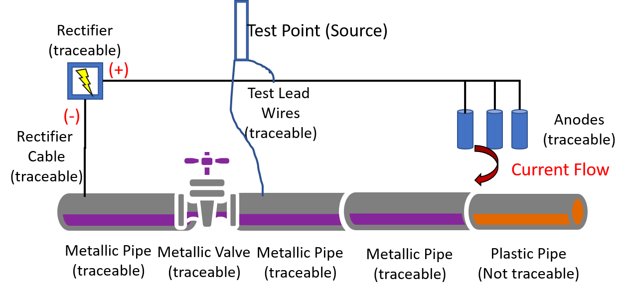

A cathodic protection zone is really an electrical circuit. Electricity flows through it to protect the connected components from corrosion. So, to understand what a cathodic protection zone is, we need an understanding of the connectivity between the components. But even that is not enough. In addition to understanding connectivity we need to understand what connected components have characteristics which will cause the flow of electricity to stop.
This means the GIS model representing the cathodic protection zone needs to know that plastic pipe is non-conducting and will therefore stop the flow of electricity. The GIS system needs to understand that devices and fittings can be insulated, and this will also stop the flow of electricity.

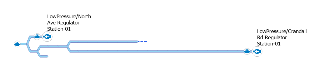

A pressure system is another example of a source flow system. The source of gas to the gas pressure zone is the regulator device. A single gas pressure zone will typically have multiple regulators feeding gas into the pressure zone.
Diagram of Pressure Zone
Within the utility network, a single domain may only have one type of subnetwork controller (Source or Sink). The gas pipe system tiers (System, Pressure, Isolation) are modeled as sources. In UPDM 2019, the Pipeline domain models the subnetwork controller type as a “Source” to support the pipe system tiers.

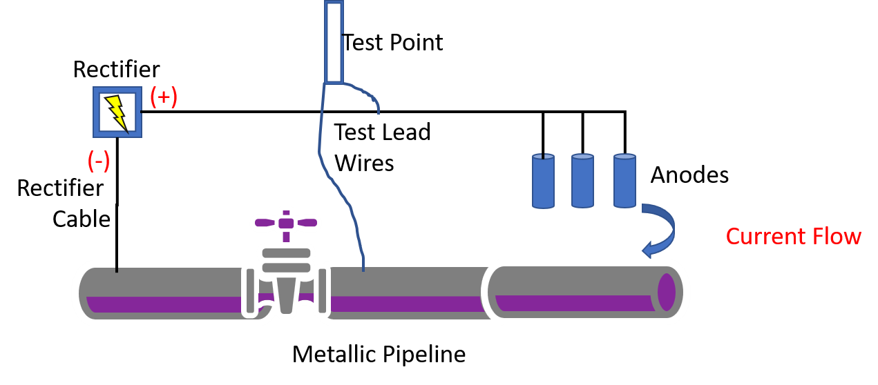

The cathodic protection system of a pipe system is not as consistent a flow model as the pressurized pipe system. For the impressed current system, the rectifier would be the logical source and the anode would be an intermediate device. For the galvanically protected system, the anode would be the logical source. Because of this inconsistency, it was decided that the best option was to make the test point the source as it is typically a part of both the galvanically protected system and the impressed current protection system.
