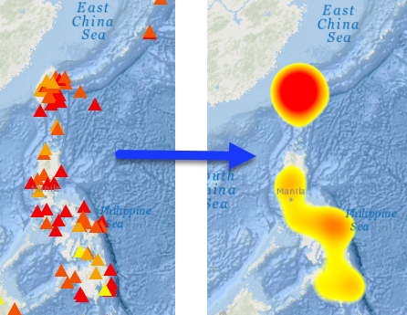

If you've ever had to show the density of point features on a map, you may already be familiar with the concept of a heat map, which allows you to generalize the display of points according to their density. A heat map provides an excellent tool for discovering patterns in your data. In addition to looking at density of point location, you can also provide a field in your dataset with which to weight the density. This allows you to look at the density of things like sales (dollars, for example) instead of just the density of customers over an area.
Heat maps are displayed with a color ramp that usually shows dense areas with a darker color (red, for example) and sparse areas with a light color (such as yellow). You may have used a heat map renderer to display your point data in the ArcGIS Online map viewer or ArcGIS Pro. The heat map below shows the density of earthquakes weighted with a field that contains the magnitude.
"Sounds great". You might be saying. "I'm excited to try it in my ArcGIS Runtime for .NET app"!
"Um, yeah. About that." I would say, sheepishly looking at my shoes.
While there is support in ArcGIS Runtime for reading things like a heat map renderer from a web map, there's no API exposed (as of v100.2.1) that allows you to construct one and apply it to a point layer without crafting the raw JSON definition. Fortunately, with a little effort, there's a way to make it much easier to work with.
