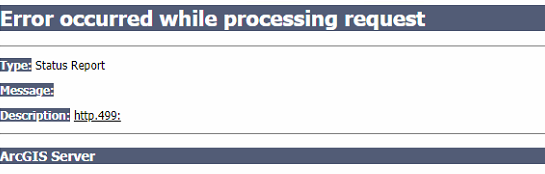

When publishing WFS or WMS services, the following error appears when querying the service URL:<\/P>
<\/P>
This is because the O Auth 2.0 protocol is not supported by OGC services when Portal for ArcGIS is federated.<\/P>
Solution:<\/SPAN><\/P>In the Portal for ArcGIS account, share the service as "Everyone" (public)<\/SPAN><\/P>
<\/SPAN><\/P>More error details at: Error: 499 Error occurred while processing request<\/A><\/P><\/BODY><\/HTML>
