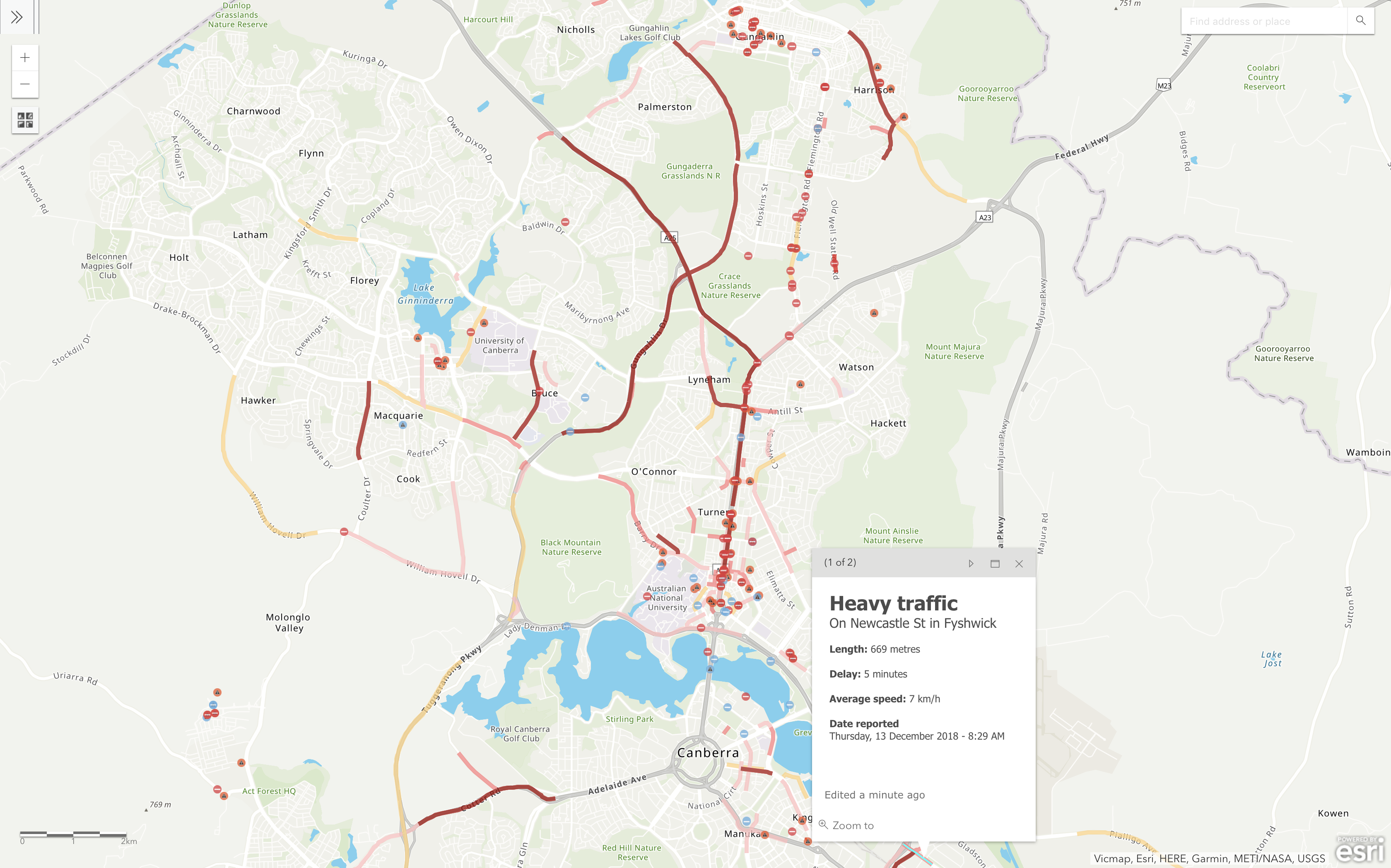

As part of the Waze Connected Citizen Program (CCP), partners gain access to real-time traffic congestions and incidents reported through the Waze app (in XML and JSON formats). There are already techniques and documentation on how to consume this data into an ArcGIS platform using GeoEvent.
In this blog, I will describe a technique for consuming this data into ArcGIS Online through Python and Windows Task Scheduler. The initial Python script was developed by Joel Meier which I modified to fit the workflow proposed. Also a special mention goes out to my colleagues Edmund Hall and Louis Tian who helped me debug. And last but not least I want to thank Andrew Stauffer for helping us parter and get the most out of Waze CCP.

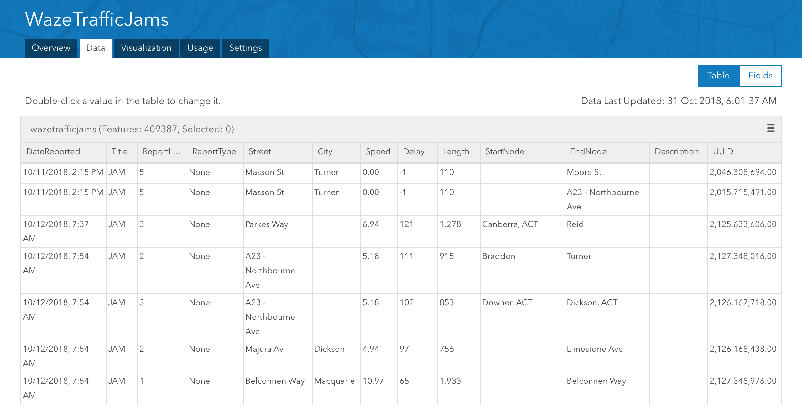

Creating ArcGIS Online feature layers to store Traffic information

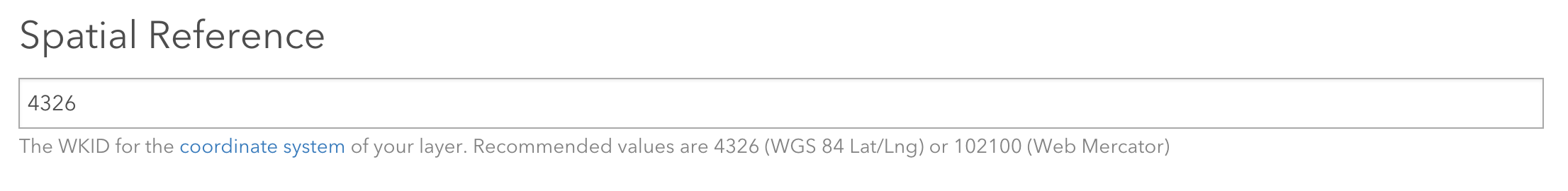

Sign into ArcGIS Online > My Content page, click Create > Feature Layer, choose From URL and enter the exact URL of the point feature layer template. Afterwards, repeat the same process for the line feature layer. This will create new empty feature layers of the schema required (field names, types and spatial reference).
Point Feature Layer Template
https://services1.arcgis.com/E5n4f1VY84i0xSjy/arcgis/rest/services/WazeTrafficAlertsEmpty/FeatureServer
Line Feature Layer Template
https://services1.arcgis.com/E5n4f1VY84i0xSjy/arcgis/rest/services/WazeTrafficJamsEmpty/FeatureServer
Alternatively, visit https://developers.arcgis.com/layers/new to create Point and Line Geometry feature layers (WKID = 4326) with the following fields.
Point - Feature Layer
- OBJECTID (type: esriFieldTypeOID, alias: OBJECTID, SQL Type: sqlTypeOther, length: 0, nullable: false, editable: false)*
- DateReported (type: esriFieldTypeDate, alias: DateReported, SQL Type: sqlTypeTimestamp2, length: 0, nullable: true, editable: true)
- Title (type: esriFieldTypeString, alias: Title, SQL Type: sqlTypeOther, length: 25, nullable: true, editable: true)
- ReportType (type: esriFieldTypeString, alias: ReportType, SQL Type: sqlTypeOther, length: 25, nullable: true, editable: true)
- ReportSubtype (type: esriFieldTypeString, alias: ReportSubtype, SQL Type: sqlTypeOther, length: 50, nullable: true, editable: true)
- Street (type: esriFieldTypeString, alias: Street, SQL Type: sqlTypeOther, length: 256, nullable: true, editable: true)
- City (type: esriFieldTypeString, alias: City, SQL Type: sqlTypeOther, length: 50, nullable: true, editable: true)
- Description (type: esriFieldTypeString, alias: Description, SQL Type: sqlTypeOther, length: 1024, nullable: true, editable: true)
- Reliability (type: esriFieldTypeInteger, alias: Reliability, SQL Type: sqlTypeOther, nullable: true, editable: true)
- UUID (type: esriFieldTypeString, alias: UUID, SQL Type: sqlTypeOther, length: 100, nullable: true, editable: true)
- CreationDate (type: esriFieldTypeDate, alias: CreationDate, SQL Type: sqlTypeOther, length: 8, nullable: true, editable: false)*
- Creator (type: esriFieldTypeString, alias: Creator, SQL Type: sqlTypeOther, length: 128, nullable: true, editable: false)*
- EditDate (type: esriFieldTypeDate, alias: EditDate, SQL Type: sqlTypeOther, length: 8, nullable: true, editable: false)*
- Editor (type: esriFieldTypeString, alias: Editor, SQL Type: sqlTypeOther, length: 128, nullable: true, editable: false)*
*pre-populated fields
Line - Feature Layer
- ReportLevel (type: esriFieldTypeInteger, alias: ReportLevel, SQL Type: sqlTypeOther, nullable: true, editable: true)
- Speed (type: esriFieldTypeDouble, alias: Speed, SQL Type: sqlTypeOther, nullable: true, editable: true)
- Delay (type: esriFieldTypeInteger, alias: Delay, SQL Type: sqlTypeOther, nullable: true, editable: true)
- Length (type: esriFieldTypeInteger, alias: Length, SQL Type: sqlTypeOther, nullable: true, editable: true)
- StartNode (type: esriFieldTypeString, alias: StartNode, SQL Type: sqlTypeOther, length: 256, nullable: true, editable: true)
- EndNode (type: esriFieldTypeString, alias: EndNode, SQL Type: sqlTypeOther, length: 256, nullable: true, editable: true)
- UUID (type: esriFieldTypeDouble, alias: UUID, SQL Type: sqlTypeOther, nullable: true, editable: true)
- Shape__Length (type: esriFieldTypeDouble, alias: Shape__Length, SQL Type: sqlTypeDouble, nullable: true, editable: false)*
Please make sure to use the exact field names and types, (alternatively you'd have to adjust the script).
Once feature layers are configured, please enable editing and set them to PRIVATE.
Please refer to "Waze Feed Technical Specifications [Get Waze Data]" from the Partner's Portal for exact definitions on field descriptions.

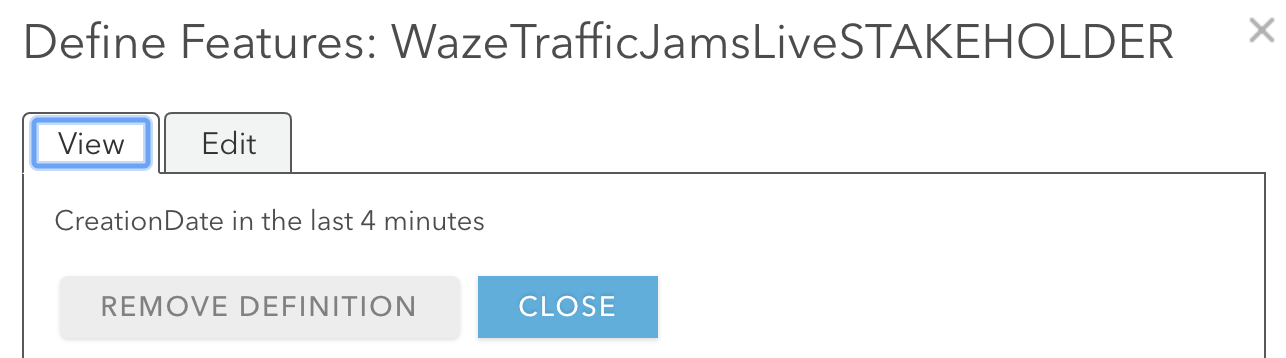

Displaying Live Traffic Information
To display live traffic information - create feature layer views and define its features to only show features created in the last x number of minutes - x being how frequently you've setup the Python script to run.
I've setup the Python script to run every 4 minutes - subsequently the feature layer views to display features created in the last 4 minutes.
Once setup, you can share these views publicly and display it on public facing applications.
Below are links to our feature layer views, and a map displaying these features alongside road/footpath closures.
*click here to find out more about our road/footpath work application process

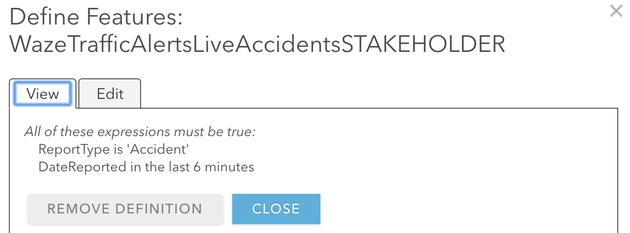

Email specific people when an Accident is reported
I used the following method, alternatively you could use similar Python scripts or create your own Python script to trigger an email when new features are added to a feature layer.
Run the email script of your choice on a new feature layer view (geometry type = point) that only displays Accidents (ReportType = "Accident"), where DateReported was in the last x number of minutes.
And finally, setup windows task scheduler to capture any new features (accidents) that occur in the last x number of minutes.
