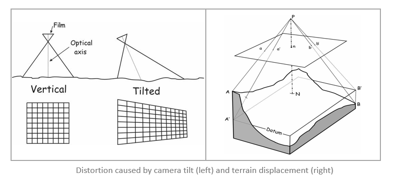

Any remote sensing image, whether it’s a drone image, aerial photograph, or data from a satellite sensor, will inherently be impacted by some form of geometric distortion. The shape of local terrain, the sensor angle and altitude, the motion of the sensor system, and the curvature of the Earth all make it difficult to represent three dimensional ground features accurately in a two dimensional map. Image orthorectification corrects for these types of distortion so you can have a measurable, map-accurate image.

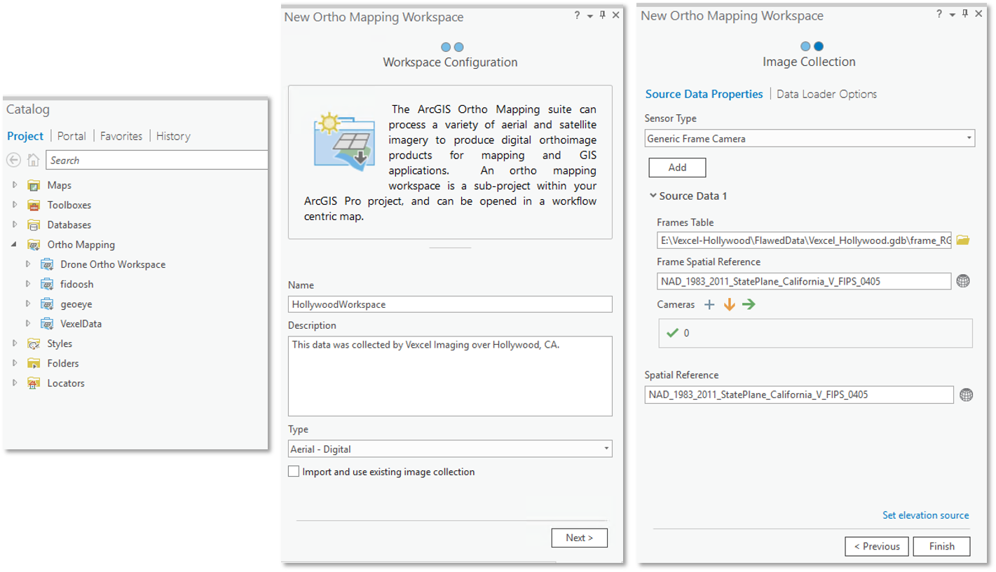

Step 1: Open the Imagery tab in your ArcGIS Pro project. This is where you can analyze and manage any raster data you want to work with in Pro. In the Ortho Mapping group, you’ll see the New Workspace menu that allows you to create a New Ortho Mapping Workspace, add an existing Ortho Mapping Workspace with a reference to that workspace, or import an Ortho Mapping Workspace by creating a copy of an existing workspace and storing the new copy in your project. Select New Workspace.
Step 2: The New Ortho Mapping Workspace wizard appears. Here you’ll give your workspace a name (required) which identifies your project in the Contents and Catalog panes. You can also provide a description (optional) and you’ll select the type of imagery you want to import. In our workflow, we’re using aerial imagery acquired by Vexcel Imaging covering an area over Hollywood, California, so we’ll select Aerial – Digital as the type. Click Next.
Step 3: The Image Collection page opens. Here you’ll enter specific information about the type of sensor used to collect your imagery. You can choose from MATCH-AT, ISAT, or Applanix, or you can select the Generic Frame Camera, which requires you to provide the exterior and interior orientation information with the Frames tables and Cameras tables, respectively. Entering the Frames and Cameras information will provide the information necessary to correct for sensor-related distortion.
The Frames table has a specific schema that is required in the ortho mapping workspace for aerial imagery. It contains the exterior orientation and other information specific for each image comprising your image collection. The Cameras table contains all the camera calibration information for computing the interior orientation, but you can add the camera information manually in the wizard or as a table. To edit the Camera parameters, you can hover over the Camera ID and click the Edit Properties button. You’ll also need to specify the Frame Spatial Reference, which be provided with your data.
In this workflow, we used the exterior orientation information that was provided along with our source imagery to create the Frames table in the necessary schema. We then pointed to a table that has the information for one camera, with CameraID = 0 (see the screen shot below - there's a check mark next to the 0 under Cameras).

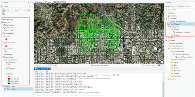

A Log window will tell you how the creation of the workspace is coming along, and if there are any problems, an error message will be displayed. When it’s complete, you’ll see the new Ortho Mapping Entities in your Contents pane: various control points including Ground Control Points, Check Points and Tie Points, the mosaic dataset that was created using your source data, and placeholders for Data Products, Solution Data, and QA/QC Data that haven’t been created yet.
Make sure to zoom and pan around the map to check out your Image Collection. With the Image Collection selected in the Contents pane, you can open the Data tab from the Mosaic Layer context menu. Here you can change the Sort and Overlap options for your mosaic dataset. We recommend using the Closest to Center or Closest to Nadir options for viewing.
