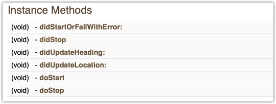

First, let's look at the AGSLocationDataSource (ForSubclassEyesOnly) API, described in the reference docs:
These methods determine how your custom location data source and the AGSLocationDisplay will communicate.
A note on naming:
- do… Instructions from the AGSLocationDisplay to your custom AGSLocationDataSource begin with "do" (doStart() and doStop()). These indicate an imperative from the location display for your data source to do something.
- did… Feedback from your data source to the AGSLocationDisplay is done by calling functions that begin with "did" (didUpdateLocation(), didStartOrFailWithError(), didStop() etc.). These indicate feedback from your data source to update the location display (e.g. the state changed, or a new location is available).
The "do" methods are expected to exist in your subclass of AGSLocationDataSource, so it's up to you to implement them.
The 'did' methods are all inherited from AGSLocationDataSource, so they're already defined for use by your subclass. You don't implement them. You just call them directly.

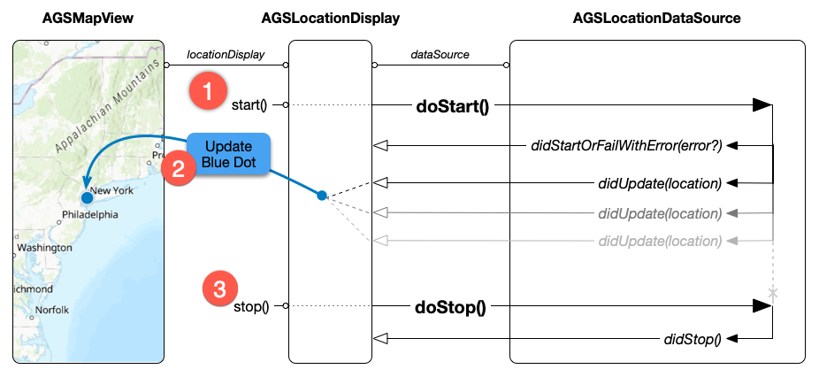

Here's how these methods work together:
- When an app wants to show location updates (by calling AGSMapView.locationDisplay.start(completion)), the AGSLocationDisplay will call doStart() on its dataSource.
- The data source initializes itself and calls didStartOrFailWithError(nil) to show it's started OK. It starts providing location updates by calling didUpdate(location) for each location update.
- When the app wants to stop showing location, it calls AGSMapView.locationDisplay.stop() and the AGSLocationDisplay will call doStop() on its dataSource. The data source calls didStop() and makes sure it doesn't call didUpdate(location) any more.
