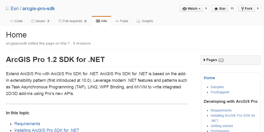

- Pro SDK Wiki on GitHub – This is the primary Pro SDK documentation site with concept and guide docs, code snippets, full code samples with Visual Studio solutions, and much more. This starting page is quite extensive, and you’ll want to take the time to familiarize yourself, especially with the format of the sitemap / page menu which runs along the right margin (screenshot below). It provides you with access to all of the main SDK topics and functional areas.

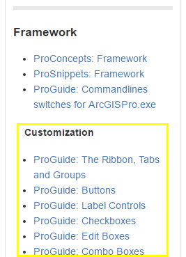

As with all of these new concepts, take a look at the community samples and see how things are done with the different Pro API functional areas. Also, take a good look at the different SDK templates that are available, and learn how and when to use each, one of the best ways to do this is to go through each of the ProGuide docs under the “Framework – Customization” topic found on the margin of the SDK wiki page, as seen here to the right.
