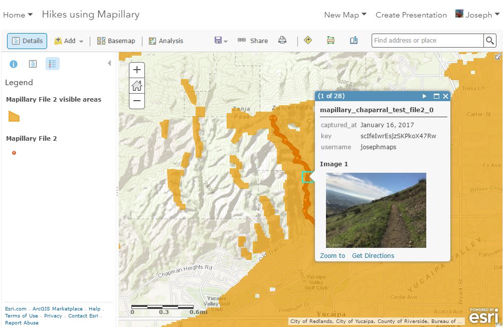

One of the most exciting things about this is that my over 1,200 points all are linked to photographs that I took while in the field. These photos are taken automatically with the Mapillary app each second or so--I did not have to touch "take photo" on my phone 1,200 times. This ensured a safer experience and also an experience where I was free to observe my surroundings instead of concentrating on the technology, which is one of the things we are always encouraging in rich and meaningful field experiences. The resulting experience in ArcGIS Online is a seamless hike up the trail, looking to each side, forward, and backward as I so chose while I was on my trek.
Next, in ArcGIS Online, I used "Add Data" to add my two GeoJSON files. I then configured a popup for the point layer. With each point, the image key is inserted into the URL, and a small image is generated in the popup that corresponds to the point where I took the photo. The idea here is to let the photo key be a variable. The resulting map is linked here and shown below. I then ran a viewshed analysis on my track so I could determine the areas I could see from this beautiful trail that wound up into the chaparral hills of southern California.
