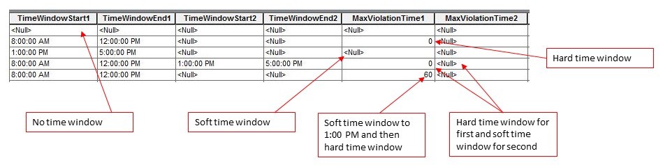

Hard vs. Soft Time Windows
Hard time windows mean that the route/driver must show up during the designated time frame of the time windows. A soft time window, on the other hand, allows the route/driver to show up late but the violation is penalized in the solver so that violation times are minimized. To indicate that the time window is hard set the corresponding MaxViolationTime to zero. Leaving this value as null makes it a soft time window. Giving a positive value for MaxViolationTime makes it a soft time window within a hard time window. This means the route/driver can be late to that location, incurring the violation penalty, but only up to the MaxViolationTime. At that point it is a hard time constraint.

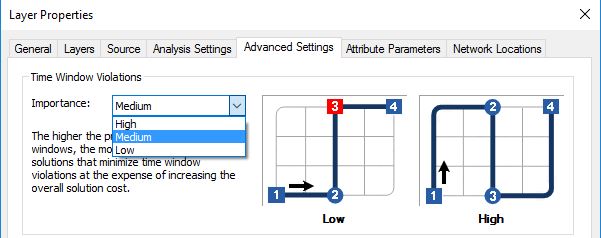

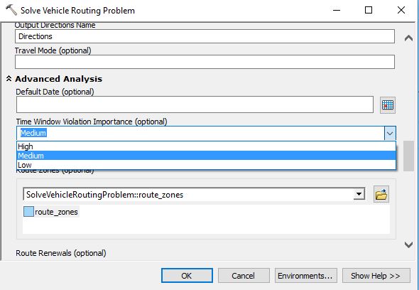

Prioritizing Time Window Violations or Total Cost
When setting up a problem with soft time windows you have the option to identify how much priority you want to place on minimizing the time window violation time vs minimizing the total cost of the routes (which includes the total time and total distance for all of the routes). These two priorities are usually working against each other. Minimizing or eliminating time window violations usually requires higher costs because. This is because the shortest tour amongst all of the stops will likely not satisfy the time windows. To indicate the preference for the VRP problem use the parameter Time Window Violation Importance. There are three options for this parameter: Low, Medium, and High.
- Low - Prioritizes minimizing the total cost over the time window violations
- Medium - Tries to find a balance between the time window violations and added cost
- High - Minimizes the time window violations at the expense of added cost

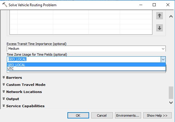

Geo-Local or UTC Time
When using the UI in ArcMap for VRP layers or the GP tools in either ArcMap or ArcGIS Pro it is natural to type in the time fields using the local time for that location (Geo-Local). However, when switching to the rest request method those times need to be converted to milliseconds since epoch. This UNIX way of representing time has a strong convention of referencing time based on UTC. Therefore, most conversion methods convert those times using UTC instead of Geo-Local.
The VRP Solver allows for some flexibility in specifying time. It allows the option of having that input as a Geo-Local time as well as UTC. You, therefore, need to specify which format is being used. This is done with the parameter time_zone_usage_for_time_fields with the two parameter options of GEO_LOCAL or UTC. Setting this parameter is only available in the GP tools or the rest request and it defaults to Geo-Local. When using the VRP layers in ArcMap there is no way to switch it to using UTC.
