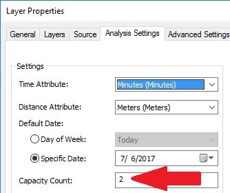

For the GP tools in both ArcMap and ArcGIS Pro and the Rest Request system this is all that is needed. When using the ArcMap UI for VRP layers there is an additional step. You will also need to go into the Layer Properties Analysis Settings and set the parameter Capacity Count to the correct number according to how many capacities you want to model.

When extra capacity values are included in the ArcMap VRP layer UI it gives a solver error. This error indicates that the order or route has a string containing too many values and will not solve. This is because in the ArcMap VRP layer UI the Capacity Count value is set. This indicates the number of values to be tracked and will not accept extras.
